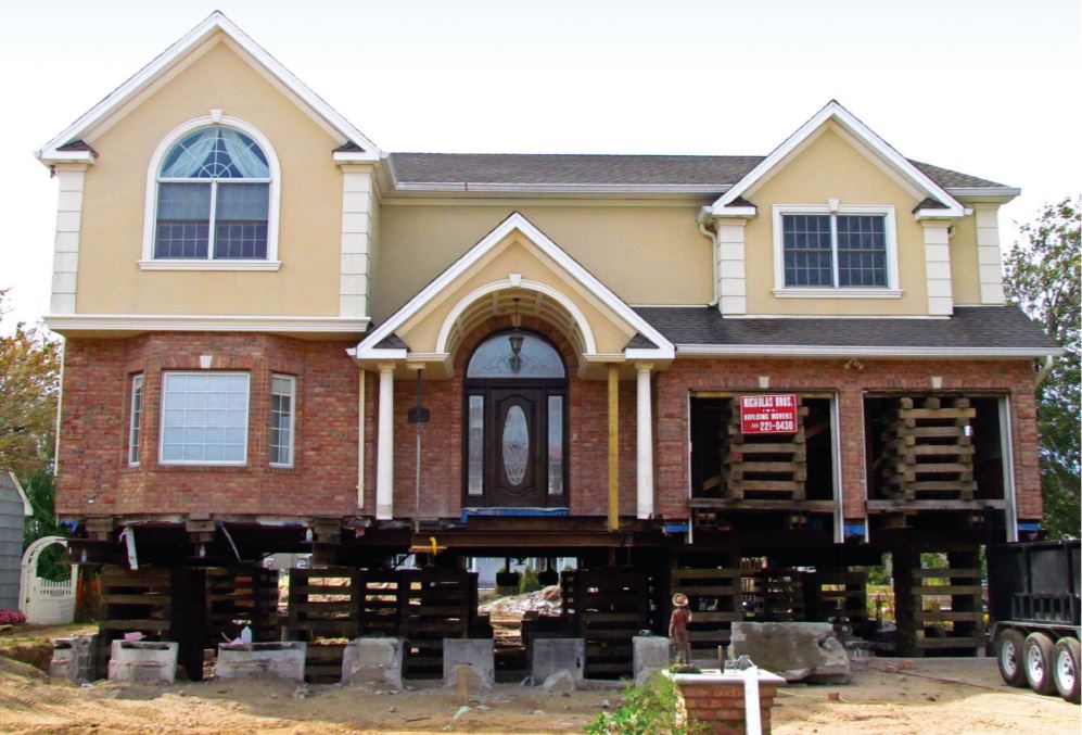

In the end, the decision was easy. I went with a house mover that had been in the business for well over 100 years, and this company was the only one that said I didn’t need to remove all the brick veneer from the house. This house also had a fireplace and chimney in the back that weighs several tons by itself, all concentrated in one point that had most of the lifters shaking their heads. But for a company that specializes in moving irreplaceable historic buildings down the throughway, lifting a house straight up and setting it back down in exactly the same spot is a no-brainer, no matter how much that house weighs. The hydraulic rig that the lifter brought to the site raises 24 jacks perfectly evenly at the same time. DeNicholas and his crew can monitor the pressure on each jack as the house goes up and can back off as soon as there’s a snag that is exerting an off-kilter force on the structure. This way there’s no twisting or racking as the house is raised.

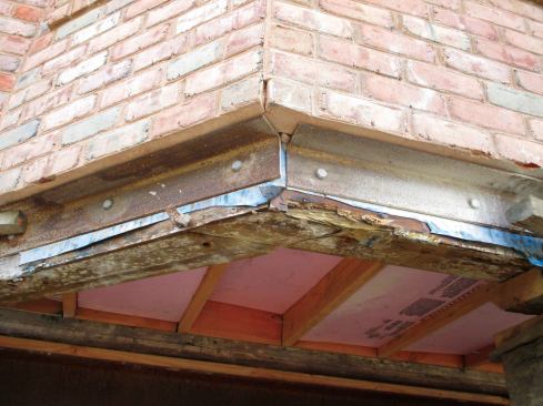

As a result of the lift, we only had one interior crack on a veneer-plastered wall. None of the brick and stucco exterior cracked from the lift except a small portion of the chimney base that we were unable to support. Everywhere else, my crews had bolted steel angle-iron to the sills when the brick was installed. As long as the building frame was well supported by the mover’s steelwork, there was no risk to the cladding.

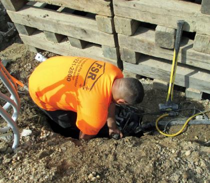

Utilities. All sewer, water, gas, and electricity lines running into the house must be disconnected. This is obvious, but chasing down all the pipes and wires can be painstaking work in a flooded crawlspace. They don’t always rise out of the ground in one place, particularly in an older home with several additions. Of course, all the utilities had been shut off soon after the storm. But a simple water pipe that remains connected can create a lot of stress when the house goes up. This kind of stress is what cracks finishes. You want the house to rise up without a hitch, literally. And even though we got everything right on the lift, we still had to cut the plate out around the power main when we set the house back down. There’s nothing like experience to develop an eye for all these details.

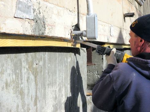

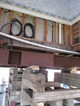

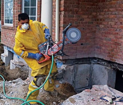

Cutting the foundation. There are two basic ways to lift a house: you can either come underneath it or you can go through it. With a house on a crawlspace, most lifters will want to go underneath, and this means you have to cut through the foundation to thread a gridwork of steel beams underneath the first floor.
Slab houses are usually cut away from the slab and the floorless frame is lifted by punching holes through the first-floor walls for the lifter’s steelwork. The steel is supported on headers, either existing ones at openings or new ones you frame in. As more and more lifters are gaining experience, this option is gaining a lot of traction, even with non-slab houses. It’s usually much easier to pop a hole through a framed wall than through a foundation wall.
In our case, however, where I wanted to keep the brick, going underneath worked better. But cutting the concrete required a huge investment of time. We used a “cut and break” tool, which is a lot safer and doesn’t throw as much water as a concrete chain saw, but it is slow going. Each hole took a couple of hours of plunging the blade in every few inches and then snapping a chunk off. Blades ran us about $400 per set. We used more than $1,000 worth of blades to cut roughly 20 square holes that were 2-by-2-feet each.

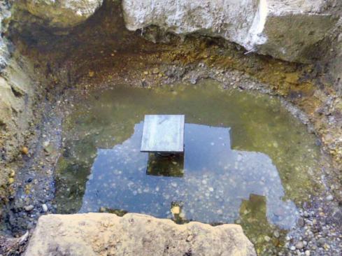

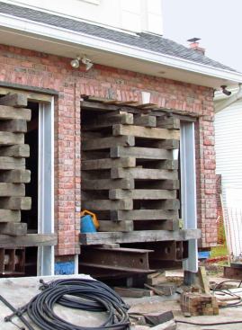

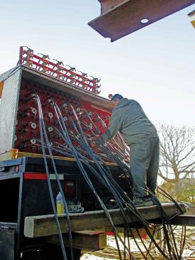

Lifting. Before the lifter threaded his steel through the crawlspace, we had to dig below the footing elevation at every location next to a footing where the lifter needed a cradle (the stack of hardwood 4x4s that support each jack). This was to eliminate the possibility of a footing collapse due to the increased soil pressure from the intense point loads near a footing.
At the garage, where there’s no sill, cradles had to be extended to the garage door header, and the front porch had to be supported on cross beams built out on cantilevered sections of steel.

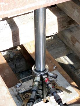

The hydraulic jacks have a throw of about 16 inches. We needed to go up to 10 feet 7 inches. To do this the lifter has to “jump the jacks.” It’s kind of the way crane operators will leapfrog their way up a skyscraper, lifting one crane over itself, and when that one’s set, it pulls the lower one over itself. In this case, some extended jacks support the house, while others are backed off and their cradles stacked higher, so this set of jacks can be extended, and so forth. Each time a lifter jumps the jacks, it costs more money.

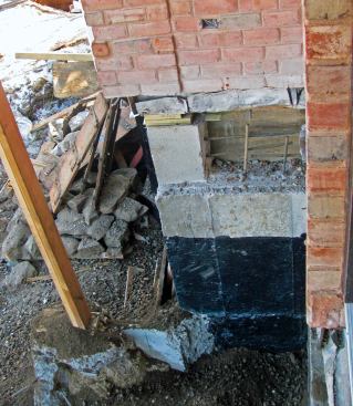

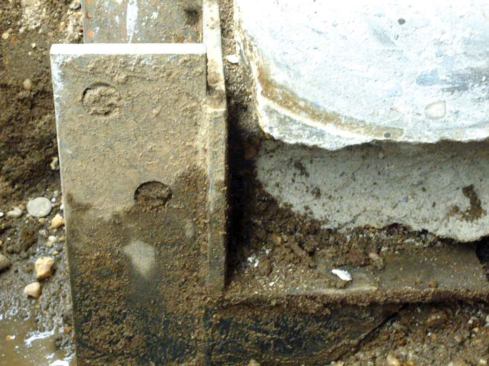

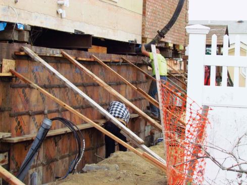

Foundation rebuild. With the house lifted, it was time to install the helical piles according to the design and to form out the footings, as described earlier. We could then stand the foundation forms. For this, you need to work with a patient foundation crew. The foundation walls needed to have pockets formed out to accommodate the lifter’s steel, and the crew needed to work pieces to fit around tight enclosed spaces. In some cases it’s painstaking work, but care and attention will pay off when it comes time to reset the house. You don’t want to be jackhammering new concrete because someone was impatient about setting formwork.
We used a pump truck with a 100-foot boom to get the concrete to the back of the house, and the pressure on this hose was tremendous. It was harrowing for the crew to try to bend that hose into the form with less than a foot of access between the house and the top of the forms. If I had to do it all over again, I would have paid for another jump on the jacks to give ourselves more room. It would have been safer and a lot less stressful.
I could have gone with CMU foundation walls. You can lift to the final elevation and just build the CMU up to meet the house. While this is certainly more affordable on several counts, I have seen what wave action can do to a block wall, and I just didn’t want to take the chance. A reinforced concrete wall is considerably stronger, and resisting storm surge is the whole reason for doing this work. Why skimp?
We poured 4,000-psi concrete. Code here only requires 3,000 psi, but I wanted to give ourselves a higher margin of safety. We conducted “tube tests” by pouring concrete into plastic cylinders that we stored in a box next to the foundation so they would cure at the same rate. The cylinders are then crushed to measure the cured compressive strength. We tested at seven days and at 21 days. After seven days you can begin cutting new sills, but you usually can’t bolt these down tight and set the house back down until the pour samples test out near 3,000 psi.
Resetting the house. When it came time to finally set the house back down, we first had to go around and check every part of the house that would touch the sill. In several places we had to cut out parts of the old frame that would hang up on the new, leveled sill plates, and even chip out some of the form squeeze-out to avoid a hang-up as the steel work was lowered into the pockets that had been formed into the wall.

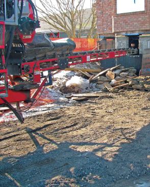

Final steps. There is still an enormous amount of site work to complete, and the utilities must be connected. We now have retaining walls all along the site perimeter and have begun the task of hauling recycled concrete fill, over which I’ll lay top soil. A conveyor truck is helping to speed the work of getting sub-slab fill beneath the house, and to spread it around the site. But at least now work can begin on remodeling the interior. Finally.
