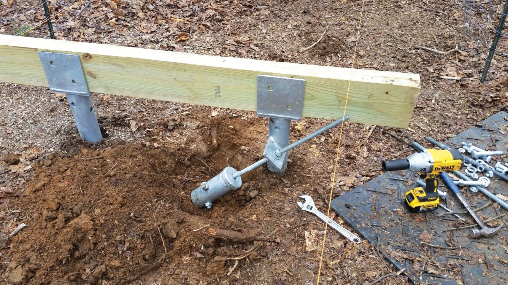

On a recent project, for example, we used what are called “batter piles” installed at an angle and in line with the framing for a pedestrian walkway for a museum. While that design would perhaps be overkill for a residential project, the ipe walkway winds through a floodplain and is subject to commercial code. Requirements include higher design loads, and the engineer was concerned about the active loads from people walking on the pathway causing the framing to move back and forth. The batter piles help prevent that movement over the walkway’s straight runs, some of which measure as much as 70 feet in length.

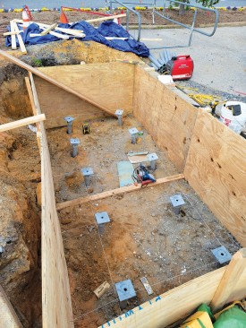

To build a foundation for a large commercial sign that is strong enough to resist the lateral and uplift forces created by wind blowing against it, the author installed pairs of batter piles, which will later be encased in a massive concrete slab. After the slab is poured, the temporary plywood walls holding back the soil will be removed, and backfill will then be compressed around the slab to meet compaction requirements.
Another example of an alternative use for helical piles is a sign pylon foundation we recently built. For this foundation, we installed opposing pairs of batter piles at a 7.5-degree angle from the vertical to anchor the sign’s steel framework. That orientation—rather than a completely vertical one—will provide better resistance to uplift once the piles are encased in a concrete base, which in this project will measure about 15 feet long, 7 feet wide, and 36 to 42 inches deep. The overall size of the mass of concrete not only offers ballast weight to the assembly but also helps increase the side-load shear factor.
