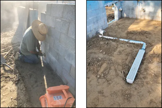

Figure 2. A worker preps the interior of a CMU wall to accept a layer of rigid foam by grinding off mortar drops and other irregularities (left). Installing drains prior to placing the vapor barrier and pouring the slab helps avoid trapping water underneath the house (right).
Planning for drains happens early in the project. We start by evaluating the pier layout, overall foundation design, and the site plan to determine the proper path for piping and water runoff from the crawlspace. Working closely with our civil engineer, we determine the best location for the drain piping outlet (on small projects) or outlets (on large projects). We also consult with our plumber, who can offer practical experience as we develop our plan for drain locations and exit points from the house. In certain localities, it may be necessary to tie this into the main waste line, in which case a check valve would also be required to prevent backflow of sewer gases.
Immediately after concrete footings have been placed, we focus on drain installation. Depending on how much dirt is excavated, it can make sense to come in with a skid steer and scrape off the high areas, but before that step can happen, a grade for the drains needs to be set. Again, we work closely with our plumber and concrete contractor to help set grade for the drains and high points out from the drains. You don’t need to create a steep slope, just enough to get the water moving; we usually don’t specify more than 1/8 inch of fall per foot.
On a typical drain layout, we try to place one drain between each row of piers (depending on the size of the house’s footprint), using the piers as the high point. But like most details on custom homes, every layout is unique. For example, on a recent project, our plumber suggested using the existing natural slope of the site and sloping the slab from one end of the house to the other, with a large linear drain installed at the low end. This saved us from having to bring in a lot of fill and relevel the space.
Once all trades involved approve the drain locations, we grade off the house footprint down to around 6 to 8 inches below the top of the concrete slab, thus allowing for 2 to 4 inches fill sand to be brought in later. While this grading tends to cause some cave-ins and footings to be covered in sand, the extra step of cleaning off the footings is well worth it compared with trying to remove excess material working around all the CMU piers and walls after they are installed.

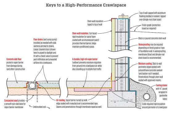

Click to enlarge
The conditioned crawlspace details used by the author’s company were developed in conjunction with architect Steve Baczek and include a slab floor over a well-sealed vapor barrier. To prevent water accumulation, the slab is fitted with floor drains.

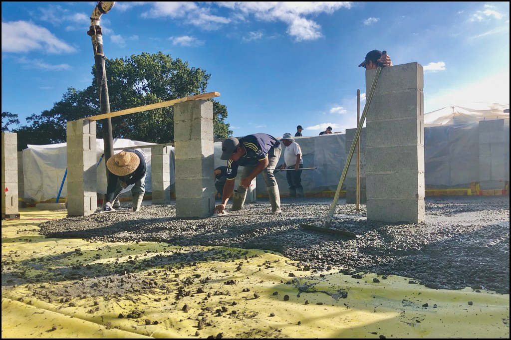

When all the CMU stem walls and piers have been laid up, it’s time to knock down any remaining high spots in whatever spoils were left from excavation and start snapping chalk lines. Once the perimeter top-of-slab lines are marked, I transfer the marks onto the piers.

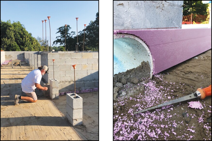

Vapor Barrier
Per code, conditioned and unvented crawlspaces require insulation. So before pouring the slab, we install a continuous 2-foot-wide layer of 2-inch XPS foam around the perimeter of the building. We start by spreading the sand evenly so that it comes up to 3 or 4 inches below our marks for the finish slab elevation, then tamp the sand with a plate compactor. Next, we use a concrete rake to excavate a 2-foot-wide-by-2-inch-deep trench in the sand along the perimeter walls (figure 3).
Figure 3. A crew member preps the perimeter of the crawlspace for a continuous 2-foot-wide layer of 2-inch XPS foam (left, right).
Using a track saw, we rip some of the sheets of XPS foam into 6-inch-wide strips, which we attach to the foundation walls at our grade marks with Poly Wall Quick Grip adhesive and a powder-actuated nailer shooting 3-inch nails through attached washers. This will allow for a full 4-inch depth for the slab after the 2-inch-thick horizontal sheets of XPS foam are butted up against the 6-inch-wide rippings (figures 4, 5).
Figure 4. Then 6-inch-wide XPS strips are fastened to the walls (left), with the top edge of the foam aligned with chalk lines marking the top of the slab. Here, the foam is aligned to the chalk line and cut around a 40 pressure-rated pipe as a “sleeve” through the block wall (right).

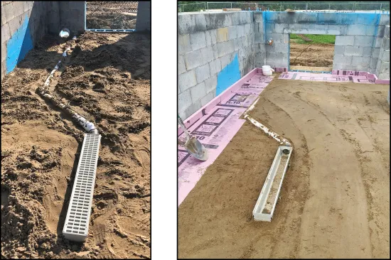

Figure 5. The linear drains are roughed in (left) and the perimeter foam is installed, the sand base is raked smooth in preparation for the vapor barrier underneath the slab (right).
