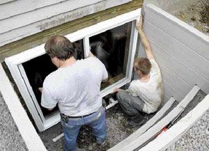

Installing the Window
With the ScapeWel backfilled and the drainage system in place, we can install the window in the opening. We use an all-vinyl sliding unit. Given the proximity to grade and the high-humidity environment, we think vinyl is a smart choice. And we use sliders because they’re easy for children to operate and don’t rely on a mechanical balance system that can fail or become less effective over time.
We caulk the nailing fin per the manufacturer’s instructions and plumb the window, then fasten it with 13/4-inch roofing nails. In the project shown, trimming out the window was not part of our contract; it would be handled by the GC.
When we do trim the window, we install self-adhering flashing over the nailing fins and use cellular PVC trim. We like the plastic trim because there’s no ongoing maintenance and no chance for rot.
The final step is to install the acrylic cover. Small metal clips hold the cover in place while allowing it to be easily opened in the event of an emergency. The manufacturer also offers a sturdy steel cover that can be used in locations where there’s a good chance someone could fall into the well, or where it’s required by code.
