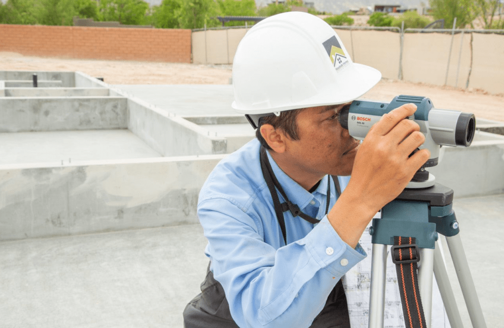

Measuring up to the task, the Japan-based and American team achieved millimeter precision.
“The collaboration between the Japanese and our crews was seamless,” says Colvin. “The Sekisui House team culture is meticulous about details and precision, and our guys appreciated the wealth of knowledge and a system that is so accurate the first time, there’s no need for retrofits, or special fits on-site. They design foundations and the process around their forms.”
Woodside’s Salerno says that, thanks to the simplicity of the system, its intuitive steps, and the ability to achieve accuracy, concrete crews who’ve been building for decades the same way in the Vegas Valley, were able to learn the Sekisui House process in a couple of hours of training.
“It’s easily 30% faster, once you learn the process, than the way we’ve done things here,” says Salerno. “And the U.S. guys embraced it with open arms.”
The Results
While the U.S. training days and excavation work were going on, two containers shipped from Japan into the port of Long Beach, Calif., with all the pre-engineered metal stands, form boards, spacer templates, and anchor bolts. Between April 9, when the team dug the base footers for the foundation, through May 3, when the team poured concrete for the home’s interior crawl space, Sekisui House foundation experts Mat and Kazu worked side by side with the Colvin Construction team.
“We poured about 180 yards of concrete for this foundation, and it’s diagonally 139 feet from the southeast corner to the northwest corner,” says Salerno. “We were 3/16ths of an inch off-square, within 5 millimeters accurate."
“With that collaboration, we were completing the work at a rate of about 1,000 dimensional linear feet with six crew members in eight hours,” says Colvin. “The way they’ve integrated the bolt template with their foundation system is revolutionary. It not only squares up the foundation, but you’ve got the anchor bolt positions punched out exactly where each one needs to be. It’s really eye-opening—the construction culture in Japan—to see first-hand how each person is so passionate and focused on precision. You can see the care and love in how they work.”
The outcome of the partnership—actually a tri-lingual job site of English, Japanese, and Spanish-speaking workers—speaks volumes.
“We poured about 180 yards of concrete for this foundation, and it’s diagonally 139 feet from the southeast corner to the northwest corner,” says Salerno. “We were 3/16ths of an inch off-square, within 5 millimeters accurate. We snap-lined adjustments, and had it perfectly square and level so that every bolt was laser-perfect when we started framing.”
