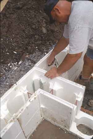

Several manufacturers make insulated concrete forms, each company offering a variation on a couple of themes. The material of choice is expanded polystyrene, the same material used to make take-out coffee cups. Forms can be shaped like the three-hole blocks of their masonry cousins, or come in pre-cut sheets held apart with plastic tees. I chose Therm-O-Wall blocks, which are 48 inches long, 16 inches high, and either 8 or 10 inches wide. At each end, and spaced 16 inches on-center, embedded plastic tees provide furring for securing interior finishes. Another feature of Therm-O-Wall blocks are their ready-made left and right corners; some systems require you to fashion corners from straight forms.
There are a few simple rules to keep in mind when laying and stacking the forms: Build the corners first, stagger the joints, and don’t try to level each course, since it’s impossible to stack the blocks perfectly. You’ll need several canisters of low-expanding aerosol urethane foam, which is the glue used to bond the form blocks together. I used Pur-Fil foam and a Pur-Fil foam gun. You’ll also need a supply of 1×4 strapping. The strapping acts like a band-aid to strengthen weak joints and bridge cracks in damaged blocks (Figure 2).

Start at the Corners
With the help of an experienced ICF block layer, I set the corner blocks, cementing them in place with aerosol urethane foam. I then stretched strings corner to corner and laid the first course, keeping the tops in line with the string and butting them against the 1×4 ledger. Where there were dips in the footing, I filled the gaps with aerosol foam; wood shims work well for large gaps. I then nailed together 2×6 L-shaped corner bucks and plumbed and braced them at each outside corner (Figure 3).
Figure 3. Plumbed and braced 2×6 corner bucks will hold the foundation dimensions as the walls are stacked. The 1×4 cleat attached to the footing keeps the first course from kicking out during the slab pour.
