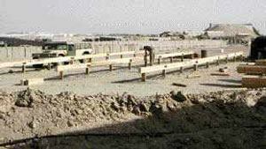

Once in Iraq, he salvaged 4x6 and 6x10 dunnage from shipping containers found around the base. He borrowed other supplies — or bartered for them — from nearby Army and Navy units and from civilian contractors who worked on the base. Sometimes he had to improvise; for example, since no roofing or asphalt felt paper was available, he caulked the roof sheathing joints, applied the thickest paint he could find, and hoped for the best.
O'Brien was in Iraq for six months. During that time, he and his helper, Lance Cpl. Brad Kucksdorf, a framer from Wisconsin, built an 11-bedroom house, a workshop, several outbuildings, and various pieces of furniture for barter. Not a bad tour of duty for a builder, considering the desert's 120°F heat and subfreezing cold, the occasional mortar round, and the IEDs (improvised explosive devices) and hidden mines that periodically detonated on the main road just outside the gate.
