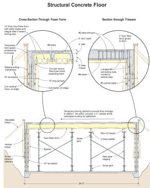

In essence, Reddi-Deck is a concrete-slab-and-joist forming system. The joist sections remain concealed within the EPS formwork, while the underside presents a completely flat, fully insulated ceiling profile.
Conjoined foam panels create a negative form of the cast concrete "T-beam" floor system. The tongue-in-groove joist-forming flanges provide a positive seal against concrete leakage between forms. Integral utility chases provide convenient channels for plumbing, wiring, or hvac runs.
Inside each 2-foot-wide foam panel are two side-by-side 4 3/4-inch-diameter round “utility chases” and four 1 1/2-inch-diameter wire chases. A pair of integral lightweight steel Z-beams stiffen the form and allow clear spans up to 8 feet, including the live and dead loads of workers and concrete. The bottom beams of these are exposed on the underside of the form and provide visible, 12-inch-on-center furring strips for drywall or other finished ceiling.
The 12-inch-thick forms, capped by a 4-inch-thick slab, create a somewhat deeper floor system than a typical precast slab or a concrete-on-steel deck. But it’s no thicker than many I-joist floor systems, so, as long as any headroom issues and height restrictions are taken into consideration during the design stage, floor thickness isn’t a problem.

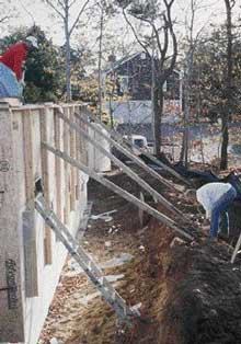

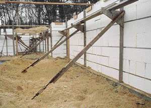

To brace the ICF forms, we use site-made 2×4 staging brackets, that both brace the forms and provide working access to the top of the wall. Adjusting screws at the anchor end of the diagonal braces make it easy to plumb the forms.
The author's site-made staging brackets provide lateral support to the ICF wall forms during the pour, as well as access to the top of the forms for pumping concrete and setting the anchor bolts and sill plate. Backers on the opposite side of the wall provide external bracing and catch the 16-inch-long screws used to attach the staging to the form work.
Backers. Since you can’t attach nails or screws directly to the foam, we use 2×4 backers on the opposite side of the wall forms. The backers also help to brace the wall form. We use 16-inch-long hex-head LogHog screws (Olympic Manufacturing Group, Agawam, Mass.; 800/633-3800, www.omgroofing.com), which I buy by the case, to attach the brackets. We drive them through the narrow edge of the 2×4 bracket uprights, through the foam, and into the narrow edge of the backers. By aligning the brackets over the webs in the foam blocks, rather than through the cells, we’re able to retrieve the screws for reuse. The best way we’ve found to drive the screws is with an electric impact wrench.

To attach the forms, we drove LogHog screws through the vertical braces and into 2×4 backers on the inside. Though we connected the top plate sections with short 2×6 scabs, we still had some bulging at the top edge during the pour, which we fixed with screw jacks. But in the future, I’ll use a continuous second 2×6 plate to reinforce the top edge.
Excavation made it difficult to install counter bracing on the exterior side of the wall. However, it proved to be essential to countering the tendency of the perimeter forms to bulge outward during the pour. Screw-jack adjustments at the base of the braces pushed the forms back into position.

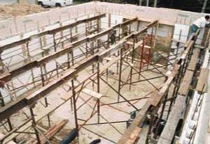

Like any cast concrete, cast-in-place joists attain the designed structural properties only after a minimum 28-day curing period. During the pour and the entire curing period, the floor system is supported by “falsework,” or temporary shoring under the forming panels. At 70 psf, the weight of this 864-square-foot floor would top 30 tons.
I opted to rent ready-to-go falsework from A.H. Harris (860/665-9494, www.ahharris.com), a large concrete contractor and forming consultant that serves New England, New York, New Jersey, and Virginia. The company provided a layout plan for the falsework, ensuring that we’d have the proper spacing and support for the overhead concrete. The entire package cost about $1,000 for a one-month rental.
The falsework consisted of heavy-duty 4×6-foot steel pipe staging, with screw jacks top and bottom. Each leg was rated for a working load of 12,000 pounds. On top of the staging, W8x10 I-beam strongbacks, set in U-head saddles over the upper screw jacks, provided distributed support for the deck forms.
The deck pan was supported by a series of 4x6-foot steel frames and braces, topped by sectional steel I-beam strongbacks. The strongbacks were arranged in four parallel rows on nominal 7-foot centers.
The deck pan was supported by a series of 4×6-foot steel frames and braces, topped by sectional steel I-beam strongbacks. The strongbacks were arranged in four parallel rows on nominal 7-foot centers.
The falsework was delivered by flatbed trailer; but the truck couldn’t make the turn through the subdivision’s narrow stone gate. We ferried the frames and accessories to the site on a smaller trailer, making a couple of trips. None of the equipment was particularly heavy; at 13 pounds per linear foot, the I-beams were the heaviest pieces, but none was over 7 feet long. This was an unanticipated snag, however, and had we ordered precast deck planks or panels, the problem would have been much harder to solve.
We set the frames, braces, and beams up in four parallel rows running the 36-foot axis, according to the shoring plan.
Drainage slope. We pitched the falsework to provide floor drainage toward the overhead door side by raising the opposite side 2 inches over the 24-foot-wide span. Not only is such drainage for a garage floor required by code, but given the building’s proximity to the ocean and salt spray, I wanted to make sure that salty water couldn’t puddle and soak into the floor and corrode the reinforcement steel. To ensure a flat surface, we stretched a stringline across the 24-foot end wall to represent the finished floor line at the planned pitch, then laser-leveled each strongback course at its location along the line. Because the ICF blocks were level around the perimeter, we glued 2-inch-wide foam rippings along the top of the 36-foot side. Expanding urethane foam is the ICF adhesive of choice. We used a combination of foam rippings and expanding foam to fill the tapering, 24-foot end-wall returns.
Camber. To compensate for the calculated dead-load deflection, I also planned to introduce a 3/4-inch positive camber at center span. I didn’t want the floor to settle and allow water to puddle. We raised the two middle strongbacks higher than the two outside courses, creating a convex floor profile across the foundation. The screw-levelers enabled us to make precise adjustments to the floor line.

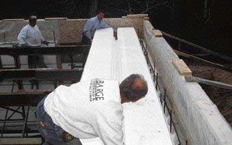

The panels were delivered in full, 24-foot lengths. But to fit inside the wall forms and leave the ICF cells exposed for filling, they had to be shortened. If not for the integral steel beams, this could be done with a hot wire. But it wasn’t much more difficult to cut them with a recip saw fitted with an aggressive hacksaw blade. Once all the forms were trimmed, we stood on the strongbacks and staging planks to set the first panels in place, then moved onto the last panel placed to complete the installation. We had all the panels placed within an hour.
The tongue-in-groove flanges snugged up to one another easily, although some of the panels had some overall sideways curvature, probably caused during shipping. We placed all the panels, then forced the curves out by wedging and blocking at opposite ends of the deck. To prevent the panels from springing and separating, we screwed 1x cleats to the underside, using the integral Z-beam flanges for attachment.

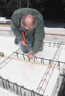

Stress relief. I had planned to tie the horizontal rebar in the joist channels to the vertical rod in the wall forms. However, my engineer was concerned that that would create a moment connection that could transfer undesirable stresses to the lower section of the wall. In the event of floor movement, expansion, or contraction, he wanted any likely cracking to occur right at the floor-to-wall junction, instead, so we cut the vertical rods flush with the top of the wall forms and used independent, L-shaped horizontal #4 connecting rods to tie the floor to the walls. These connecting rods extended 3 feet onto the deck and rested on 3-inch-high wire chairs, with a 2-foot leg hanging down into the wall cells.
The right-angle connecting rods were tied to the #8 longitudinal rod with #2 rebar stirrups, placed 5 inches on-center over a 3-foot run.
To eliminate a moment connection, steel rebar connecting the floor system to the walls was installed independent of the wall rebar, providing for possible movement in the floor to be released at the top of the wall.
We united the connecting rods and the horizontal #8 rod with a series of #2 rebar stirrups, placed 5 inches on-center and tied to the connecting rod with wire twists. We also ran horizontal rods around the entire deck perimeter for a bond beam effect.

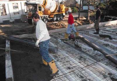

My flatwork sub, Will Daniels, placed a 5,000-psi mix in a continuous pour to the prescribed 4-inch floor thickness over the forms. Will noted that the foam panels felt sturdier underfoot than any all-steel pan system he’d worked on. We were able to pull the mix truck up near the top of the wall and chute the mix around the floor. This was really convenient, because, ordinarily, the cellular configuration of the wall forms requires the mix to be pumped. The deck pan and the running gap around its edge enabled us to distribute the concrete to the perimeter without the added cost and hassle of pumping.
Bad vibes. We used a cordless concrete vibrator to move and settle the mix. I like the cordless tool because it’s less aggressive than a typical corded vibrator, providing just enough temporary flow and plasticity to settle the mix without overpressurizing the ICFs. Nonetheless, it pays to be cautious. Al Wood kept an eye on the underside of the system as we poured. A good thing, too, because he noticed the 2-inch foam spacers we’d installed to help slope the deck pan begin to bulge and move off the blocks at the middle of the 36-foot-long wall. I backed off vibrating in that area, and we avoided a blowout. In hindsight, we could have screwed a retaining cleat to the underside of the deck forms, attaching it to the integral steel furring flanges, to prevent the spacers from moving.
Backing off on the vibration averted a blowout.
The pressure generated by vibrating and compacting the concrete began to force pieces of retrofitted foam blocking out of place, despite the use of foam adhesive.
