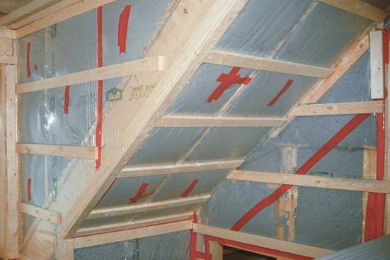

In the colder parts of the U.S., builders typically install polyethylene under the drywall, calling it the “vapor barrier.” But the most important function of polyethylene is as an air barrier. Moisture follows air leaks, moving through holes in a house, at much greater rates than it passes through solid surfaces as a vapor. Most of the problem-causing moisture that condenses in attics and building cavities is transported by interior air leaking through holes in the air barrier.
An air barrier should be continuous with the thermal insulation. In most cases, the air barrier will be on the warm side of the thermal insulation, but it doesn’t have to be. In some cases, it makes sense to establish the air barrier on the outside of the thermal insulation.

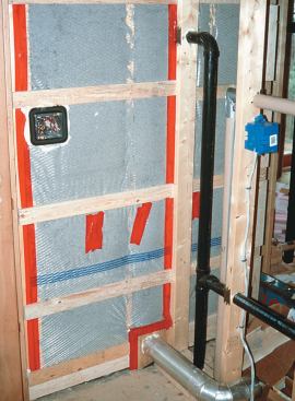

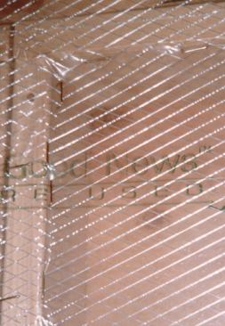

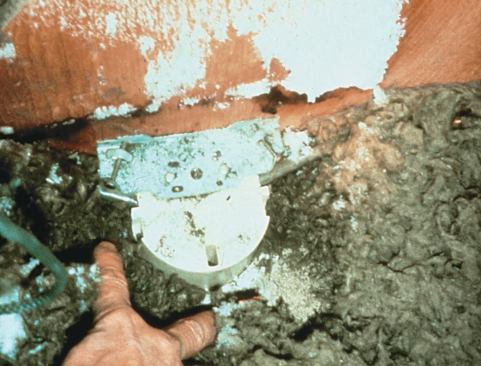

Assemble your materials. For a careful air-sealing job, you’ll need to be sure you have a few important materials on hand: reinforced polyethylene (for example, Tu-Tuf, Good News Reused, or Tenoarm); Tremco acoustical sealant (a multi-purpose air-sealing caulk that sticks to polyethylene); 3M Builders’ Sealing Tape (also called contractors’ tape, it’s used for polyethylene and housewrap); airtight electrical boxes (from Ryeco or LESSCO); and a good urethane foam gun (see “Sources of Supply”).

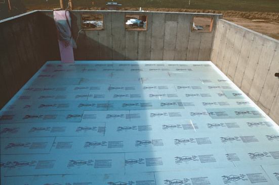

We always install 6-mil polyethylene and at least 1 inch of rigid foam insulation under all of our basement slabs. Besides saving energy, the foam keeps the slab warm, greatly increasing comfort and helping to minimize condensation. After installing crushed stone to the depth of the footing, we lay down the poly and then the rigid foam. We also install a strip of 1-inch foam at the perimeter of the slab, between the slab and the foundation wall, as a thermal break. If the basement floor is getting radiant heat, we’ll increase the thickness of the under-slab insulation to 2 inches.

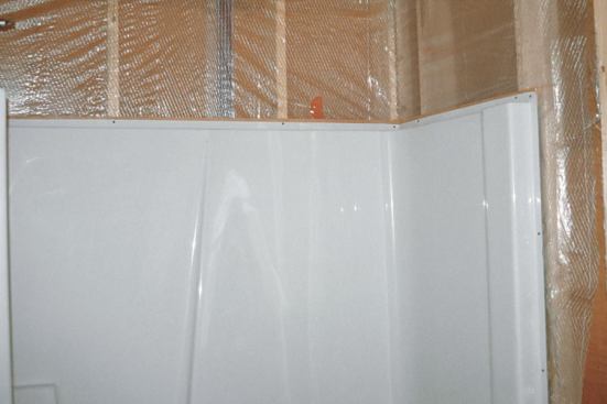

Insulating basement walls. We no longer insulate our basement walls from the exterior, since exterior foam is vulnerable to insect damage, and above-grade foam is difficult to protect. Instead, we frame up 2×4 walls inside the basement, leaving a 2-inch gap between the back of the studs and the basement wall. This allows enough room for the installation of R-19 fiberglass batts, which we cover with flame-retardant poly from Poly-America. One advantage of interior insulation: With the 2×4 perimeter walls installed, all it takes is wiring and drywall for a customer to finish the basement.

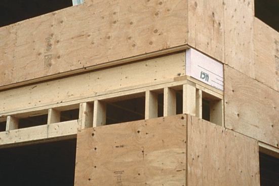

Cantilevers. Cantilevered floors are particularly difficult to air seal, especially if wires or pipes create an air path through the floor and up the exterior wall. At the point where the cantilever begins, we install solid blocking between each cantilevered joist. The edges of the blocking, as well as any penetrations through the blocking, get carefully caulked. Because the plywood subfloor over a cantilever is the air barrier, be sure the subfloor is installed with construction adhesive. Finally, the bottom of the cantilevered joists need to be wrapped with housewrap.

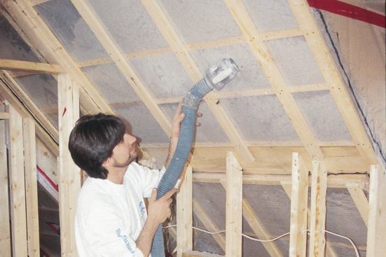

Most of our walls are framed with 2x6s, 16 inches on-center. If the studs are spaced wider than 16 inches, the dense-pack cellulose insulation pillows out, interfering with drywall installation. If the customer is willing to pay for an upgrade, we space the 2×6 studs at 24 inches on-center and then install horizontal interior 1×3 strapping at 16 inches on-center. The strapping restrains the cellulose and also provides a thermal break between the drywall and the studs.

Where an interior partition meets an exterior wall, we install a vertical 1×8, 1×10, or plywood piece as a drywall nailer. This nailer needs to be continuous (not a collection of scraps), and it needs to be wide enough to provide room to tape the poly air barrier in the corner.
