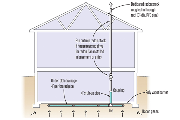

Q: When you’re mitigating radon gas, is there a way to prep a house to avoid running an ugly pipe up the exterior façade?
A: Josh Girard, who owns and operates North Country Construction, in Jericho, Vt., responds: In retrofit situations, it’s sometimes hard to avoid using an exterior pipe, but with new construction, it’s fairly easy and inexpensive to do.
I build in northwestern Vermont in Radon Zone 2 where radon levels can vary widely, even from one lot to another within the same development. The predicted average indoor radon screening levels can range from 2 to 4 picocuries per liter (pCi/L)—meaning houses have a “moderate potential” for the presence of radon gas, according to the EPA. So as a matter of course with all new construction, I rough in a dedicated radon stack in every house I build in case a house tests positive for radon.

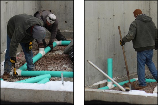

I tie the radon stack into the under-slab drainage system from the get-go. This beats a future retrofit situation of having to core through the concrete floor and install a single pipe down into the sub-slab gravel—that approach will mitigate radon gas, but it will be far less effective than tying the stack into the drainage system.
From the perforated sub-slab piping, I stub up a 4-inch piece of pipe into the basement (the poly vapor barrier is taped to the pipe and the slab is poured around it).
Crew members “tee” off the under-slab drainage piping (top left) and stub-up a 4-inch pipe into the basement (top right).
The plumbers take it from there and reduce the pipe down to a 3-inch PVC schedule 40 vent pipe. The pipe is then typically run through the exterior wall into the attic space. From there, it’s run through the roof and flashed with a standard roof vent boot.
A radon fan can be easily cut into the stack, if needed; I typically install the fans in the basement.
Although it’s another roof penetration I have to account for, a dedicated stack is cheap radon-mitigation insurance. A ready-to-go remedy beats an ugly pipe run up the exterior façade every time.

A 3-inch pipe is run from the basement into attic and through the roof. A radon fan is cut in, if needed.
A 3-inch pipe is run from the basement into the attic and through the roof. A radon fan is cut in, if needed.
