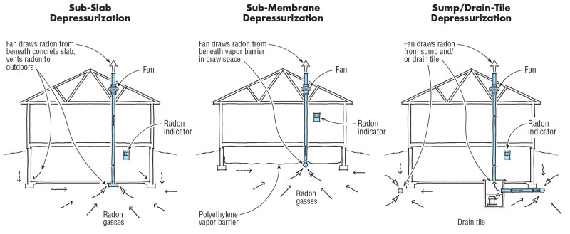

Different strategies for venting radon are required for different foundations: Houses with basements (left), houses with crawlspaces (center), and basements or slabs with sump chambers (right). The usual approach in new construction is to build-in, at a modest cost, the depressurization infrastructure. This typically needed only for homes in mapped  zones with a risk for radon. Once the house is built, it can be tested, and only if radon concentrations are sufficiently high, do you need to install an inline fan to actively mitigate the risk.

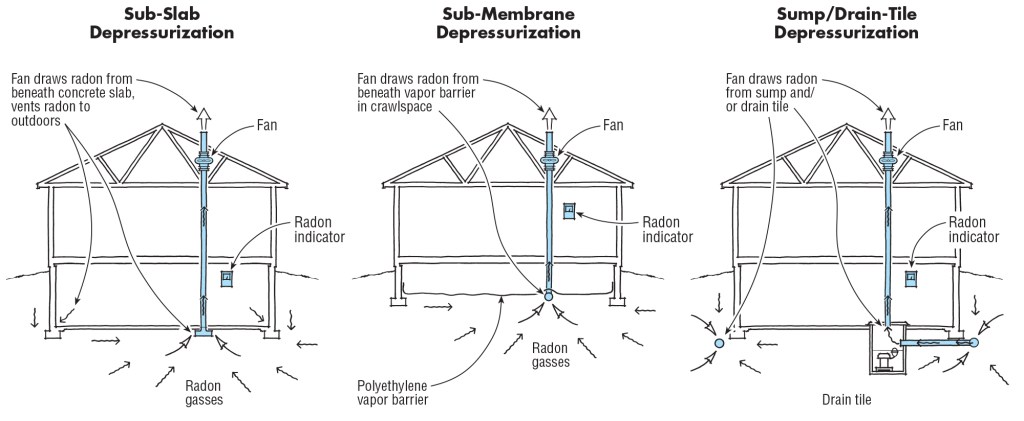

The EPA recommends the following system to prevent radon from entering basements and crawlspaces, and to exhaust radon from below slabs to the outdoors:
  • Subslab: Place gas-permeable layer (4-in. layer of clean gravel).
  • In basements: Plastic sheeting should be placed on top of gravel sub-base and under slab.
  • In crawlspaces: The sheeting is placed over the crawlspace floor.
  • Seal and caulk all cracks, joints, or penetrations.
  • Use 3- or 4-in. PVC vent stack from sub-slab to above roof. Mark this clearly so plumbers won’t mistake it for a drain vent.
  • In attics: Supply a junction box for power in case homeowners choose to install a powered vent fan.
