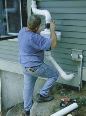

Vent Stack and Fan
With the inside piping done, we connected the vent pipe to the fan and ran it up the exterior wall and through the gable-end overhang (Figure 6). Purely by chance, an existing weatherproof outlet was perfectly positioned to bring power to the fan motor. After we finished up, the builder’s carpenter built an enclosure around the fan and boxed in the exposed pipes.
Figure 6. External vents always require a fan to provide a reliable draft. The vent pipe was secured to the fan housing with standard neoprene plumbing connectors before continuing up the wall of the house (left). The finished assembly — located on an inconspicuous outside elevation — was later boxed in for a more finished appearance (right).
