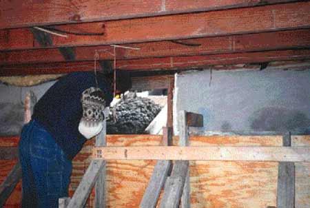

A second section of the foundation lacked anything as heavy as a porch foundation to connect to, but it did have a convenient window for getting concrete inside. In that section, we decided to pour a heavily reinforced wall inside the existing foundation for additional strength.

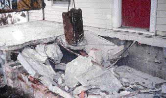

The first section of foundation was below an existing concrete porch. I was concerned that removing the existing porch slab would damage the house or siding as the pieces were broken up. To prevent damage, we used a gas-powered cutoff saw with a diamond blade to cut the slab close to the house.
Once most of the pieces had been broken up and hauled away, we removed the smaller pieces, using a little more finesse than the improvised ram attached to my subcontractor’s backhoe.
When the porch was gone, I had the excavator scrape away the soil from the damaged foundation and trench below the frost line for the new porch footing. I wanted to keep the bearing capacity of the soil, so we were careful not to over-dig.
