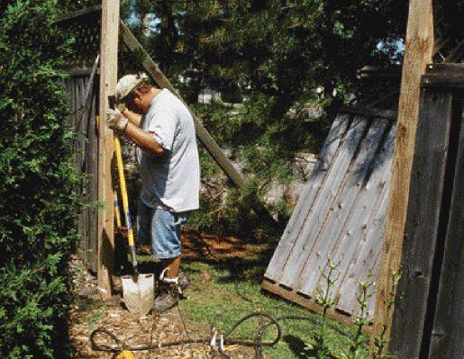

Whenever possible, we try to reuse the original fencing panels and replace only the posts. Unlike the posts, the fence panels aren't in contact with the soil, so they're much less prone to decay, making reuse a practical option in most cases. But because the wood is typically dry and brittle, it's likely to split if you attempt to pull out the toe-nails that hold the horizontal stringers to the posts. To avoid that frustration, we simply cut through the nails with a bimetal demolition blade in a reciprocating saw (Figure 2).
Figure 2.The crew first cuts through the toe-nails that secure fence panels to rotted posts (top). This allows intact fence sections to be removed and set aside for reuse as replacement posts are installed (bottom).
Once we've set the fence sections aside for reuse, we dig around the post to the depth of one shovel blade. If the post isn't set in concrete, I then take the pointed end of my wrecking bar and stab it into the side of the post a few inches below ground level while my helper does the same on the opposite side. We lever the post upward in unison, taking a fresh bite with the bars as needed. If the ground is soft, we use scraps of 4x4 as fulcrums between the bars and the edge of the hole. If the base of the original post was set in concrete, I sometimes rent an electric jackhammer to break the concrete ball into manageable chunks (Figure 3).
Figure 3.When the original posts are set in concrete, removing them takes time and may leave an oversized hole that requires extra concrete to fill. Breaking up the old base with a rented electric jackhammer saves time and trouble.
The local frost line is at about 42 inches, but I've found that setting post bases at a depth of 24 inches reliably prevents any heaving. After cleaning up the hole with a posthole digger and making it deeper if necessary, I drop in an 8-foot pressure-treated 4x4, renail the stringers, and fill around the post with bagged concrete mixed by hand in a wheelbarrow (Figure 4).
Figure 4.A replacement post is nailed to an adjacent fence section and plumbed with temporary bracing as site-mixed concrete is poured around the base (top). Bringing the concrete up to grade protects the post from rot where it is most vulnerable (bottom).
