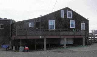

Recently, our company was hired to remodel a 1950s beach cottage just south of San Francisco. The job included repairing the house’s seriously damaged foundation.
Our original plan was to shore up the building, replace the support beams, and reuse the existing wood piles. But once we got the house supported by cribbing and temporary steel beams and started excavating around the piles, we found that they extended only 4 or 5 feet below grade rather than the 15 to 20 feet we’d been expecting.
Since the existing foundation could not be saved, we had to design, gain approval for, and build a new one from scratch. And, with the house up on cribbing, we had to hurry. The house mover’s liability insurance would not cover us if the shoring remained in place for more than 90 days, a real concern with the winter storm season approaching. If a big wave hit before the foundation was done, the cottage could be destroyed.
Although we had already planned to drill new piers for the decks, these weren’t an option for the house unless we moved it out of the way or drilled from below with a handheld rig. But moving the house would be too expensive, and drilling with a handheld rig would be difficult with so little headroom above and so many stone cobbles in the sand and gravel soil below.
Instead, we decided to remove the piles and support the cottage with concrete columns extending up from a modified version of a mat foundation, which was designed for us by Joshua B. Kardon, a structural engineer in Berkeley, Calif. A mat foundation is a thick and heavily reinforced concrete “slab” stiff enough to span weak areas of soil. The mat is usually continuous, but this one would be grid-shaped, because we planned to leave the house where it was and form around the temporary cribbing. We would place the foundation in a monolithic pour, so that the cured grid and columns would act as a unified whole.
