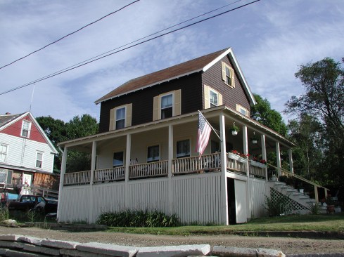

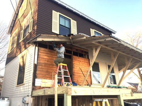

The proposal was fairly simple. The owners of this seaside home, built in 1900, wanted to rebuild a weathered and worn porch from the roof eaves down to the ground (below). We would also enclose a portion of the existing porch to extend the living space, and renovate the kitchen. The house is an existing, non-conforming structure located within 75 feet of the area’s high-tide line—in other words, inside the City of Portland’s Shoreland Zone (as mandated by state law). Consequently, we were not allowed to expand the building’s footprint, and all new construction needed to take place within the home’s existing dimensions.

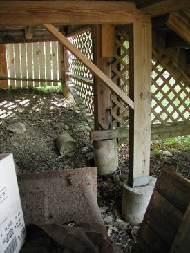

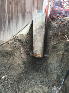

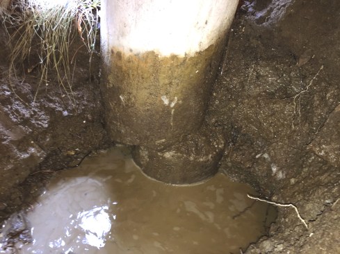

The house was built on concrete piers. Some of them were obviously tilting (see slideshow), and the home’s floors were uneven. Clearly, the foundation had moved in response to winter frost action in the clay soils. As a result, the house was hinging at the first floor, toward the beach. So, right from the start, the scope of work grew to include an investigation of the existing concrete piers (which had been replaced once already, improperly, not long ago) to determine whether they all reached 4 feet in depth (as required in Maine) and whether they were set on solid footings.

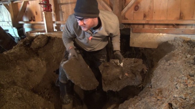

We knew we would have to fix a select few, but after some digging, we discovered that none of the existing concrete piers extended below the 4-foot frostline. Many were only 18 inches deep. We also didn’t find any spread footings under the piers. So, Heather wrote up a change order to cover the cost of replacing every pier. Eventually, we ended up replacing most of the building’s piers.

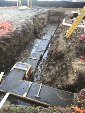

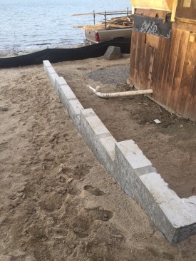

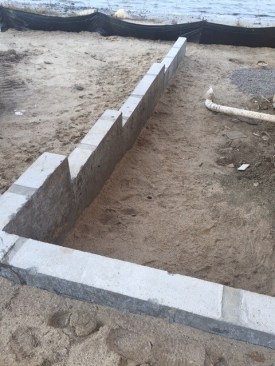

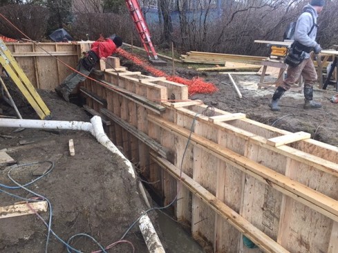

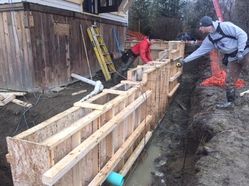

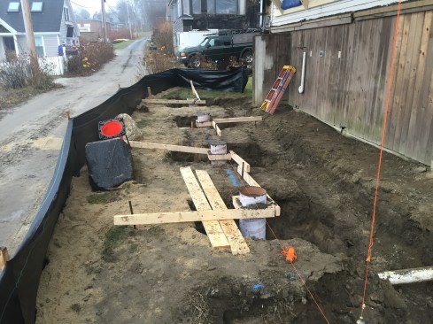

Since the frost wall supporting the home’s porch—within the existing footprint—was already approved on all accounts (DEP, Shoreland Zoning, building code), as long as we didn’t place fill in the front yard, we agreed to move forward and build that part of the project. If the owners ever decide to invest in the fill and the more intricate drainage system and approval process down the road, that wall is ready to go.

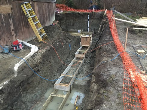

In building the wall, we had expected to hit ledge just a foot or two below grade—at least at the uphill end of the wall. But, it turned out that the heavy clay soil was deep—so deep that we had to dig down to below the frostline, build wooden forms, pour a spread footing, and form up and pour our stepped frost wall.
Excavating for that foundation wall made the drainage problem on the site more evident. We didn’t have a particularly rainy fall; the puddles you see in the photos are typical at this location even in a light rain. Puddles also indicate tidal and ground water.

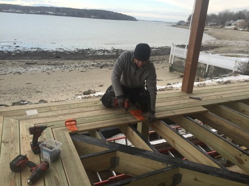

Peaks Island, where we work, is a vacation destination with relatively few year-round residents. Most of the homes we work on are summer vacation houses. Customers do not want you to build in June, July, or August. So that means most of our projects—and certainly the big jobs—happen in the fall, winter, and spring, and we’re always racing to finish excavation and concrete work before a hard freeze. This year, we were lucky: We were able to get the frost wall poured in November, before freezing weather set in. By the time it got really cold, we were decking the new porch (7).

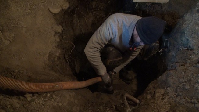

Unfortunately, the freezing weather did hit before all of the concrete piers under the house were replaced. The cold weather, combined with the drainage issues, compounded the difficulty of digging and pouring in that low space.

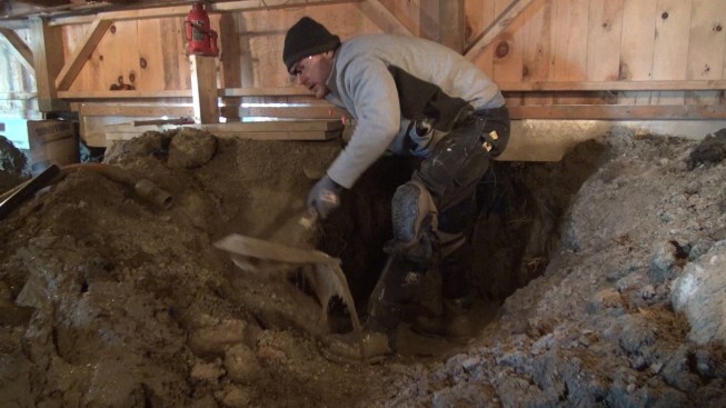

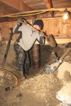

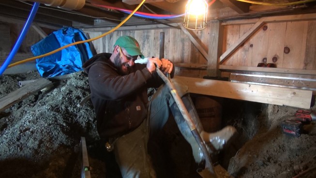

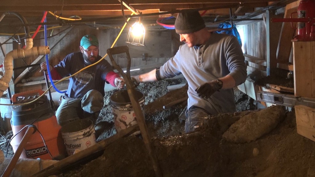

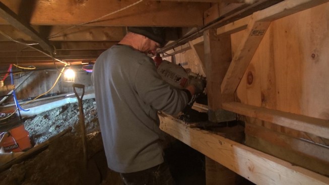

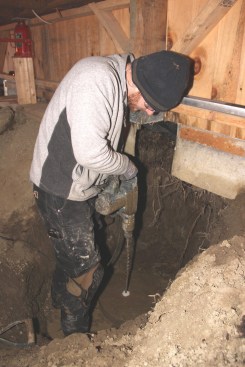

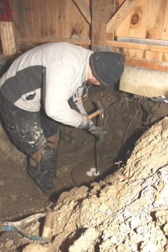

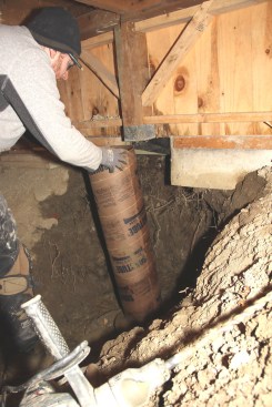

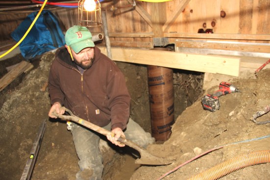

The hard part of pier replacement is digging in unforgiving crawlspaces, which are typical on the island and familiar to Heather’s crew. On one crawlspace job, the crew had to cut the handles on their shovels short and crawl on their stomachs beneath the house to get started. This time, we hired a local subcontractor and his crew, who dug the piers out by hand, one at a time. That crew also set disc-shaped precast concrete footings in place, 6 inches thick by 24 inches in diameter.

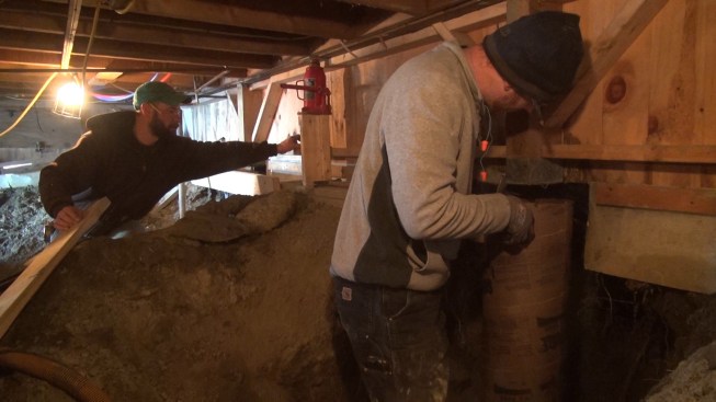

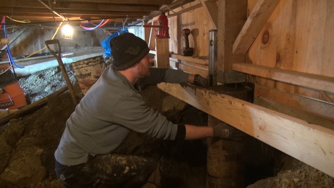

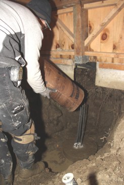

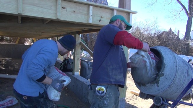

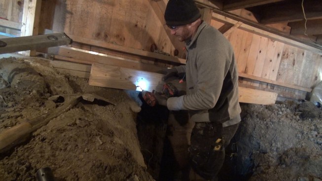

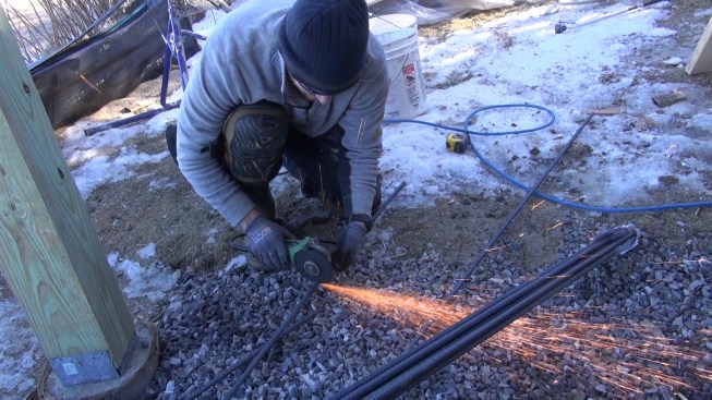

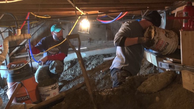

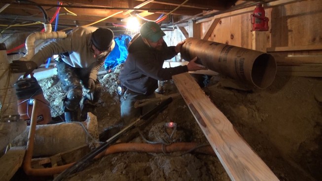

After the holes were dug, water and fine mud seeped into them and then froze. When Heather’s carpenters, Shane and Chris, were ready to pour new piers, they had to start by breaking surface ice and pulling it out in chunks, and then pumping out the remaining mucky water. Once that grunt work was out of the way, the job was simple. Shane and Chris just had to drill holes into the footing disks, hammer 5⁄8-inch rebar into the holes, set Sonotube forms over the rebar, backfill around the bases of the tubes to stabilize them, and fill the forms with concrete.

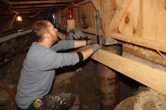

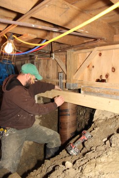

Working under the floor in the crawlspace slowed things down. It’s muddy work: The thick, sticky clay collects on everyone’s boots and clothes. Shane and Chris had to mix concrete outside in a portable mixer, then carry the wet concrete into the house in five-gallon buckets, dump the buckets out onto a board next to each tube, and push the concrete mix into the tube with their hands. They plumbed the freshly poured piers under the existing floor frame supports and braced the tubes with 2×6 lumber. After the piers set and cure, they’ll reframe the posts down onto the new piers.
