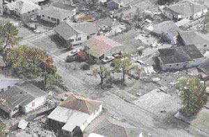

In New Orleans, floodwaters from Hurricane Katrina lifted homes off their foundations. The direction the buildings moved depended on the wind direction as well as on the ebb and flow of the floodwaters.
