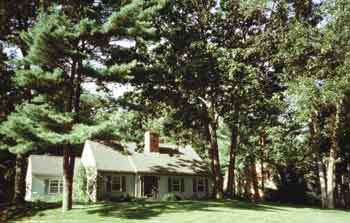

If you don’t start thinking about tree protection until the excavator arrives on the site, you’re beaten before you start. A successful project requires planning the project around the trees, rather than just trying to minimize damage as the job proceeds. This involves walking over the site as early in the process as possible, identifying and flagging desirable trees, and marking their positions on the site plan. With that information in hand, it’s possible to plan the locations of roads, utility lines, materials storage areas, and the siting of the house itself with an eye toward saving as many of the desirable trees as possible (see Figure 1).
Figure 1. The initial site survey of a wooded lot should note the locations of all trees to be saved and delineate root protection zones. Planning well in advance of construction makes it possible to adjust the position of the house to accommodate desirable trees.
