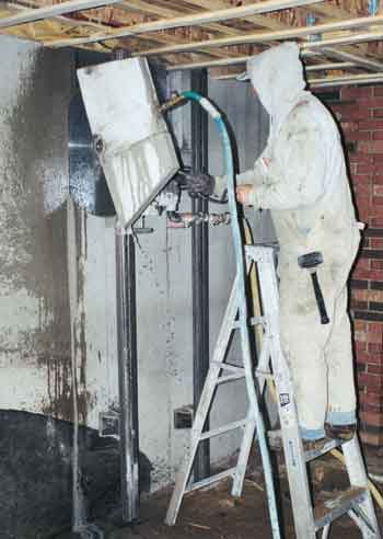

The tool of choice for many of these cuts is our Cushion Cut diamond wall saw, which is available in hydraulic, electric, and pneumatic models (Figure 2). Our pneumatically driven saw operates at a low 90 to 100 psi, but requires the high-volume output of a heavy-duty 185 hp, trailer-mounted compressor. We can handle cuts up to 18 inches deep using this tool, but we aren't usually called on to saw anything thicker than 8 to 10 inches. Although the saw itself is rated for blade diameters from 24 to 42 inches, the largest diameter requires a lower-rpm, higher-torque motor than the one we use. Our workhorse — a 24-inch-diameter blade that costs about $600 — is good for handling aged concrete, hard aggregate, and moderate steel reinforcement.
The Cushion Cut diamond wall saw can handle 24- to 42-inch-diameter blades and cuts up to 18 inches deep. It takes about three passes to cut through an 8-inch wall.
Embedded rebar doesn't pose a problem, unless a horizontal rod coincides with the line of cut. That tends to deflect the blade from its intended path and cause excessive wear, so we'll occasionally have to relocate a cut slightly. The manufacturer rates our 24-inch saw blade for a life span of 5,000 inch/feet, or 625 linear feet of 8-inch-thick wall. Although the brazed sawing segments (Figure 3) can be replaced when worn, it makes more sense to buy new blades — the blade blank is the cheapest part. On rare occasions, a segment will get knocked out during use and go zinging off the walls just like a ricocheting bullet, so the work can be dangerous at times. Anyone working in the vicinity should definitely wear safety glasses.
