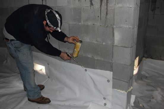

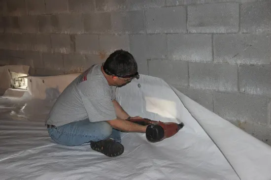

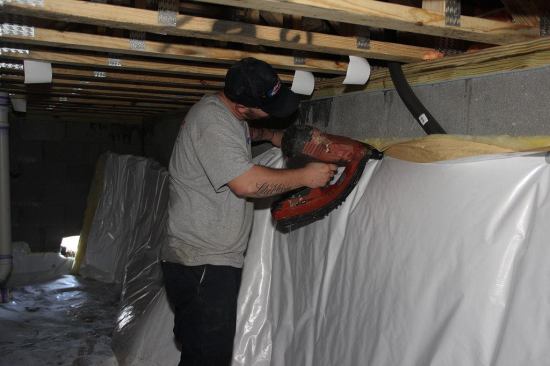

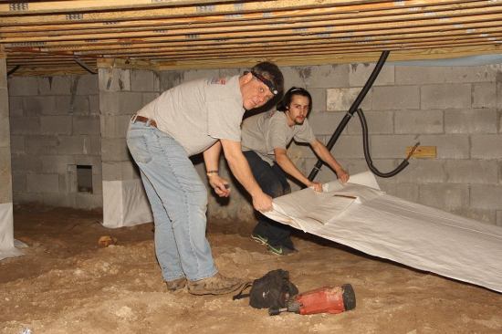

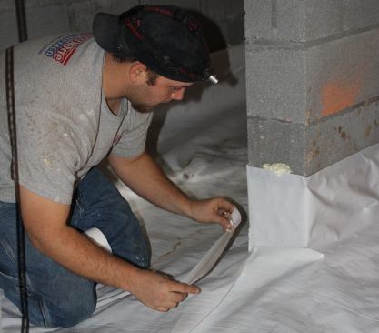

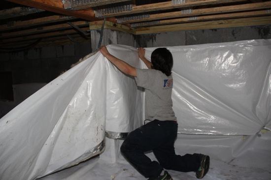

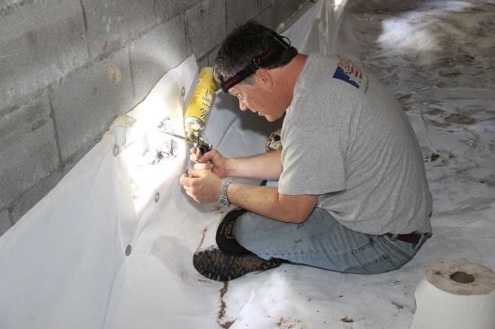

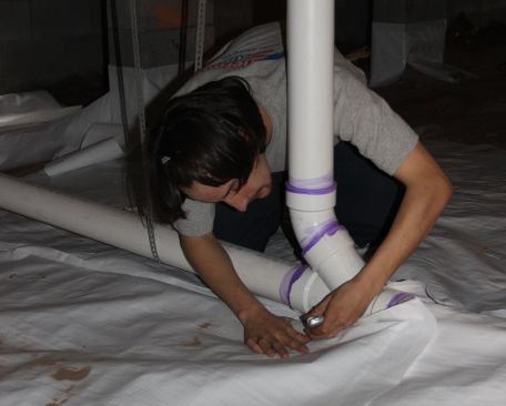

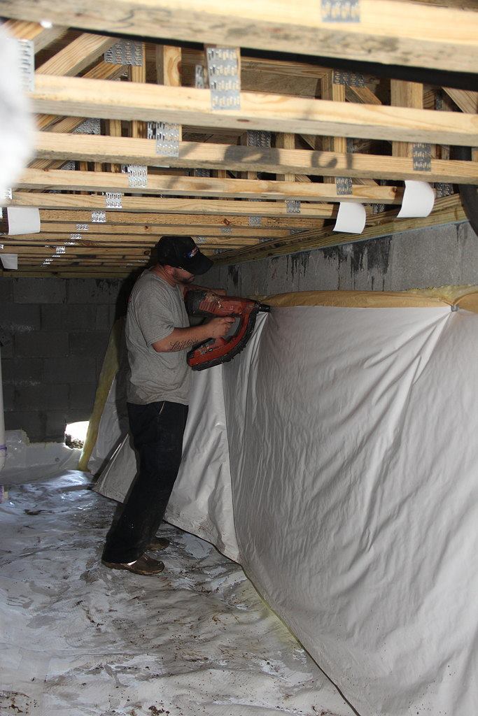

With offices in Hilton Head and Charleston, S.C.,specialty contractor Energy One has created thousands of sealed crawlspaces over the past ten years, in both new and existing homes. We followed along as the crew installed and sealed the ground-cover vapor barrier under a new house, then applied poly-faced rolls of fiberglass insulation to the perimeter walls.
This house is located in the AE flood zone along the Wando River in the Charleston neighborhood of Daniel Island. So the crawlspace is required to have flood vents to relieve the pressure of high water in case of a flood—which complicates the air-sealing problem. In this case, Energy One was only contracted to install the ground cover and wall insulation; the builder’s crew installed “Sealed Series” Flood Flaps.

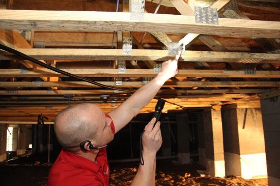

However, Energy One planned to return as soon as the doors and vents were in place and a dehumidifier was installed. That’s because in the damp South Carolina climate, mildew had already started to grow on the surface of the building’s floor framing. As soon as the humidity in the space is controllable, Energy One will be back to scrub the floor framing with a sanitizing cleanser. Energy One also sells a long-term mold-inhibiting surface treatment, but in this case, the builder has opted for cleaning only. Once the crawlspace is sealed against vapor and air intrusion, mildew probably won’t return unless the dehumidifier fails. To keep tabs on that risk, Energy One will install a humidity sensor alarm in the space.
