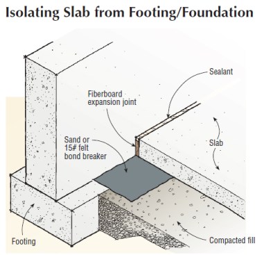

If the slab is contained by walls, you must provide expansion joints (also known as isolation joints) around the inside perimeter of the foundation to allow the slab to move independently of the wall. The same thing holds true for structural columns — if they are inside the area of the slab, they should be surrounded with expansion joints.
Residential expansion joints are often made with 1/2-inch-thick fiberboard strips. The material can be flush with the surface of the slab if appearance is no concern. For a more finished look, run the length of fiberboard on a table saw to score it 1/2 inch below the top edge (which will be at the surface elevation) so you can easily remove the top 1/2 inch after the pour. Then use a caulk to seal the slab edge.
Remember that the slab must be isolated from the footing, too. Either sand or 15# felt between the slab and footing works well as a bond breaker.
Breaking the bond between the footing and the slab with felt paper or sand will help prevent cracking as the slab moves.

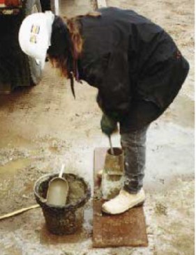

Although few residential contractors use them, slump tests ensure that the concrete coming out of the truck is not too wet.

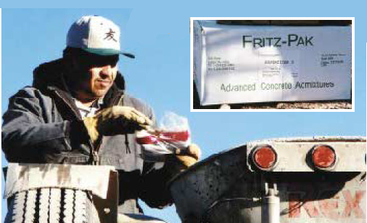

If better flow is needed, add a superplasticizer.
Slump. Proper water content is one of the most important elements of good quality concrete; adding water to concrete to make it flow has a measurable negative result. A slab mix should not have a slump greater than 3 to 4 inches. If smoother flow is required, add superplasticizer, which gives the effect of a 6- to 8-inch slump without weakening the mix.

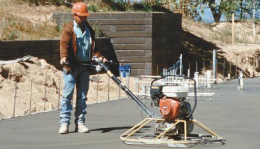

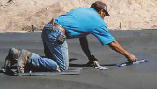

Make sure concrete is screeded and bull-floated as it’s placed, but don’t allow finishing to begin until the bleed water has disappeared. If bleed water is worked into the concrete while finishing, the surface will be weakened. For the same reason, don’t allow finishers to add water in an attempt to ease finishing.
A well-organized, well-timed, uninterrupted work flow is essential. Hand-trowelling the perimeter along walls and around obstacles as concrete is being placed is a good way to start.
All bleed water should have left the surface before any handfinishing or power-trowelling begins.
Even with a power trowel on the job, some hand-finishing is necessary around obstructions.
Have the power trowel fueled up and ready to go before you need it. If you exercise a little patience before power trowelling is begun, you can avoid displacing the softer concrete and causing potential low spots in the finished slab (Figure 9).

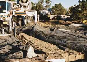

If there is any chance of freezing, blankets are used to protect the subgrade before placing the slab.
The fresh concrete is then covered for at least three days.
