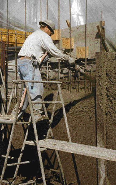

Wet mix, which is what we use, is better for engineered applications requiring high strength. (To avoid confusion, we call wet mix “shotcrete” and dry mix “gunite,” although some people refer to both as shotcrete.) In the wet-mix process, the concrete itself is mixed at a batch plant and delivered to the site like standard ready-mix. At the site, it’s dumped into the hopper of a powerful pump that forces it through a hose to where it’s needed. A supply of compressed air, delivered through a separate hose, is mixed with the concrete at the nozzle to spray the concrete against the receiving surface.

Single-sided forms. The first step in setting up a single-sided form is determining which side of the resulting wall is to be formed and which side is to be sprayed and troweled. If we need a perfectly true inner surface in a basement, such as a wall that will be faced with thinset tile, we may set the form on the inside and shoot against it from the outside. The problem with that is that it requires a much wider excavation to provide the shotcrete crew with room to work. For above-grade applications, that’s not an issue.
Compared to the forms used for poured concrete, single-sided shotcrete forms can seem pretty flimsy. One shotcrete foreman told me that a form is heavy enough if it doesn’t move when shaken by hand. We use 3/4 plywood for the straight runs and gentle curves and 3/8 plywood doubled for tighter radii. The plywood is typically set up with a snap tie cut in half, and single waler brackets holding either vertical or horizontal 2×4 walers. In some cases, we’ll make “lost forms,” which are not stripped but simply buried in the ground and left there. These can be made from ordinary U-channel steel studs faced with drywall or an expanded metal lath with stiffening rib called SureForm.

No matter what the specs call for, though, the reinforcing steel must be very rigid (see Figure 1). This is an important difference from cast-in-place concrete, where the rebar can be allowed to rattle around inside the form. If the rebar moves at all when the shotcrete is gunned against it, the concrete can slump or fall away from the rebar, leaving voids.
Figure 1.In this basement application, the lower part of the wall will be shot against the bank, which has been covered with a waterproofing membrane. The above-grade section is backed by a single-sided plywood form. To prevent the completed rebar grid from vibrating when struck by the high-pressure stream of shotcrete, the top will be wired to the plywood form and the bottom to rebar projecting from the floor slab. Number 2 wire chairs, not shown, will be wedged between the grid and the bank or form to maintain the proper spacing.
