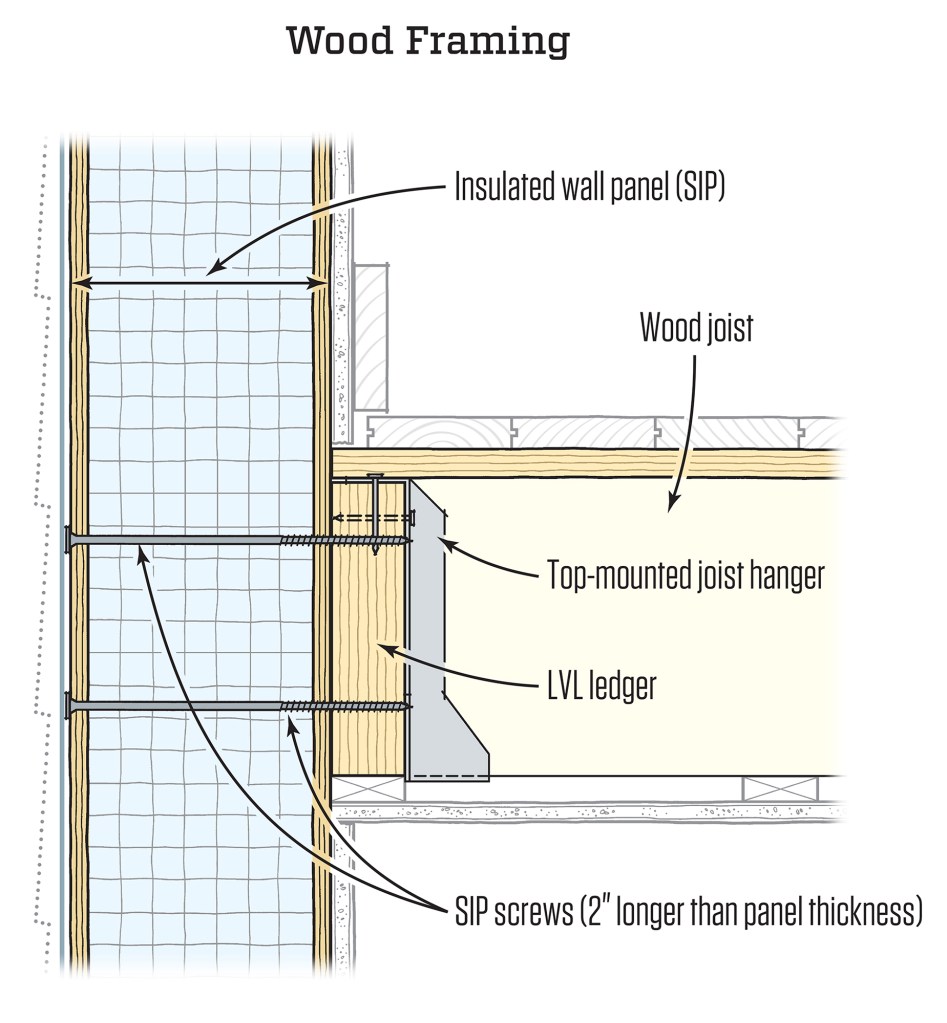

After you’ve installed the wall SIPs and roof SIPs, and your house is weathered in, you’ll be able to install all the deck framing in a protected indoor environment. At that point, there are basically two options for framing the floors: conventional wood joists or light-gauge-steel joists (see illustrations, below). Let’s look at wood framing first.
WOOD FLOOR FRAMING
Where the wood floor-framing members—whether they’re composite joists or dimensional lumber—meet the exterior SIP walls, they should be attached to a ledger, flush-framed (meaning that the tops of the joist are flush with the top of the ledger) and hung on top-mounted joist hangers. The trouble with that strategy, however, is that the horizontal flange of the joist hanger that rests on the top edge of the ledger is usually more than 1 1/2 inches deep. To eliminate this problem, we always specify that the ledger be an LVL.
The LVL ledger is fastened to the inner skin of the SIP by first tacking it in place with 3-inch screws. Then, specialized SIP screws are driven through the wall and into the ledger from the outside. These screws should be 2 inches longer than the nominal wall-SIP thickness, so for a 6-inch-thick SIP, use 8-inch SIP screws. Depending on the loads, the SIP screws may or may not require washers under the head. The spacing will vary according to your engineer’s specifications, but I always recommend spacing the pairs of ledger-attachment screws no more than 12 inches on-center.
