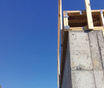

Out-of-Square Footings and Foundations
The need to keep footings and foundations square should be obvious, right? Still, nothing will stop a job quicker than finding out the foundation wall forms are overhanging the edge of the footing or the sill plates are overhanging the foundation walls. When these problems occur, it is worth pausing and reaching out to a design professional for direction on how to compensate. In some cases, the solution may be as simple as fastening a ledger to the side of the foundation to provide support for an overhanging sill plate. But in more drastic instances, more extensive or creative modifications to the foundations may be required. Depending on the scenario, it could be a much more difficult repair after the walls have been poured and even worse once the framing is installed.
Measure twice, pour once. Solutions for a miss-poured foundation will vary, but the sooner the mistake is identified, the greater the range of options will be to fix it.
Prevention: Measure twice, pour once. Make sure all measurements are checked prior to pouring. We recommend having an established process that clarifies whether the builder or the foundation contractor is accountable for verifying all dimensions prior to pouring the walls and footings and before any framing is set. Preferably, this is defined in writing in the subcontractor agreement.

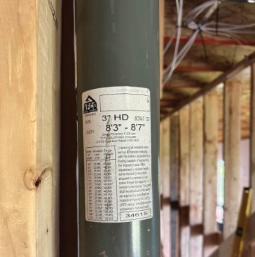

Incorrect Steel Pipe Columns
Not all pipe columns are created equal (in the literal sense). For typical adjustable steel pipe columns, each manufacturer has its own rated load-carrying capacity. Many manufacturers require screw jacks to be embedded in the concrete, while others may have varying capacities for when the screw jack is not embedded. All column capacities will vary with the height of the column—so the column will have less capacity in a 9-foot basement versus an 8-foot basement. A good set of structural plans will provide thorough column specifications or provide column design loads to enable the correct column to be selected.
Check allowable loads. Manufactured pipe columns each have their own rated load-carrying capacity listed on the label. In this example, the center column of numbers shows the allowable loads.
Prevention: First, ensure that the full specifications include the size and type of column and that the rated capacity of the columns is stated on the construction documents. Second, make sure your firm sources the appropriate column called out in the specifications that achieves that rated capacity. Third, verify that the installers are aware of the installation requirements (for example, they know whether the screw-jack assembly needs to be encased in concrete, know which end is designated as “top,” and so forth) and are clear on where each column is to be placed. This is especially important when columns with differing load capacities are specified for the same house.

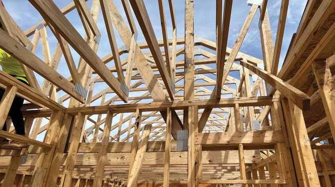

Out-of-Level Wall Top Plates
Wall top plates that aren’t level often go hand-in-hand with out-of-level foundations. Experienced framers will ensure they are building from a level foundation—and they also will check for level at each framing level. Modern construction practices often rely on precut studs or prefabricated wall panels to increase the speed of production. If these components are not checked as they are installed, an out-of-level floor condition can go unnoticed until an “easy” fix is no longer viable.
Check for level at every level. An out-of-level floor has telegraphed all the way to the top wall plates, resulting in roof trusses that have no bearing.
Prevention: It’s good practice for builders and subcontractors to check for level at each floor. Also, they should make no assumptions about installing prefabricated components—everything should be measured and verified as the components are installed at each level.

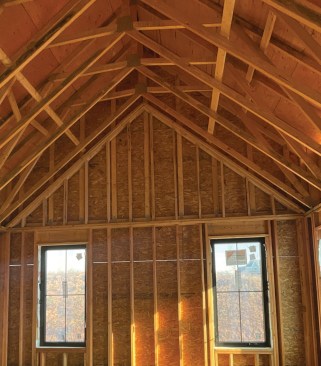

Balloon-Framed Wall Construction
As of the 2021 IRC, the code provides specifications for wood-frame load-bearing stud walls up to 12 feet tall. Any walls that are taller than 12 feet are required to be engineered to resist both gravity and wind loading. A stacked wall is not adequate to resist wind forces against the face of the wall—the studs need to be continuous over the full height of the wall. The balloon-framed construction information should be provided on the construction documents and, depending on conditions, may be designed in a variety of ways. Make sure framers are aware of the design intent—that they know why they are being asked to build in a specific way. We feel that having the framers understand the design is the best way to ensure that the final construction matches the design provided in the construction documents. This also makes sure it happens at the beginning of framing, as retrofits can be especially tricky after the exterior wall sheathing has been applied or windows and doors have been installed.
Weak hinge. A stacked gable end wall in a vaulted ceiling creates a “hinge” point in the wall that may provide inadequate resistance to wind loads. To avoid this condition, tall walls should be balloon framed.
Prevention: We always recommend that builders go through the plans with the framers to review and understand how balloon-framed walls are intended to be framed. If there are any questions about the design, the builder should reach out to the building designer for clarification. This is especially important for tall walls with multiple openings, like a great-room window wall where additional king studs are required.

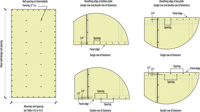

Shear Wall/Braced Wall Construction
Bracing walls is an especially important aspect of wood frame construction that can be easily overlooked. The shear-wall construction is especially important in regions with high wind speeds and/or high seismic activity, but it should not be overlooked in areas with low wind speeds, either. It is especially important to understand given the shift in code requirements over the past 10 to 15 years. When designing for even low-wind-speed regions, engineers are required to detail and specify proper load paths for both lateral and uplift loads.
Nailing is critical to an effective shear wall. This illustration shows nailing specifications from the ANSI/AWC 2021 edition of Special Design Provisions for Wind and Seismic.
Prevention: Knowledge is power. We recommend builders review the plans prior to construction so they are aware of these requirements and ensure that the framers understand and follow all notes, details, and specifications. Shear wall engineering and detailing is an easily misunderstood aspect of construction. When in doubt, ask for more clarification from the engineer prior to moving forward when possible. Based on feedback from builders, we’ve found that providing graphic details that depict a condition—in lieu of written descriptions on the structural plans or within the structural notes—is often the best way to help field personnel understand the design.

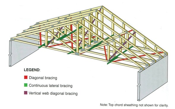

Incorrect Roof Truss Bracing
Roof truss bracing is commonly installed incorrectly on the projects that we inspect or review, even when it’s clearly detailed on the structural plans and truss shop drawings. This is largely due to the complexity of the bracing requirements and the fact that those requirements come from multiple sources. The truss manufacturer is responsible for providing the bracing requirements for individual truss members. This is the most easily recognized portion of the bracing that is shown on the truss shop drawings. However, there is another level of bracing that is required, known as the “Permanent Restraint or Roof Truss System Bracing.” This bracing is specified in the BCSI (Building Component Safety Information) manual under Chapter B3 and may also be provided on the construction documents. The silver lining here is that most truss bracing is easily modified or retrofitted. In most cases, truss bracing is easily added, but it’s easier if it can be added during the construction phase.
Permanent bracing is critical to the structural integrity of a trussed roof assembly. The truss manufacturer and building designer are responsible for providing the bracing requirements, while the builder is responsible for installing the bracing correctly.
Prevention: A builder’s construction team working with roof trusses should have access to and familiarity with Chapter B3 of the BCSI. In those 15 or so pages, diagrams and graphics are provided to help present the material. It is also important that builders understand that they are responsible for installing the bracing correctly, even if the building officials don’t see it or properly enforce it. Our firm has been involved in multiple situations where improperly installed and/or missing truss bracing wasn’t caught until a homeowner’s third-party inspector went through the house. It is much easier to complete the truss bracing correctly during construction than it is to disclose to a homeowner (or whole community of homeowners) that a critical structural component was never installed.
