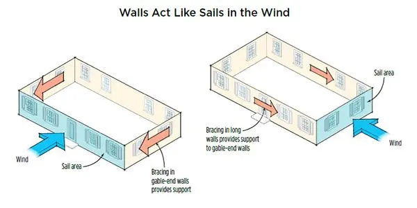

But a windstorm affects walls the opposite way, explains Foley. Walls that are facing the wind feel the wind pressure, but it's the walls parallel to the wind direction that do the work of resisting the force.
For example, take a typical colonial that's just a simple 25-by-50-foot box (see "Walls Act Like Sails in the Wind," above). When the wind blows against the 50-foot wall, it's the two short gable-end walls that have to handle the load; when the wind blows against the 25-foot wall, the bracing in the 50-foot walls comes into play. "With wind, the shorter wall has to resist more loads than the longer wall," says Foley. "And so shorter walls need more bracing than long walls in a wind situation — just the opposite of what they need for an earthquake." This means that builders who want to have a lot of glass on the short gable-end wall of a shoe-box-shaped building just might come up short in the bracing department.

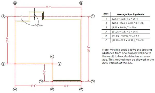

A prime example is that the old code required a 4-foot braced panel at every corner and one every 25 feet on-center, and if you wanted a window at the corner, you had to hire an engineer. In the 2009 and later code versions, however, the requirement for a 4-foot solid wall section at every corner is gone. Now, the nearest bracing panel can fall as far as 10 feet away from the corner (see "Locating Braced Wall Panels," page 36).
