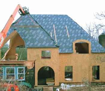

Installing the Roof Panels
Stick framing can always be adjusted when sections of a building don’t align perfectly. SIPs are less forgiving, however, and the complexity of this roof allowed practically no room for error. If my layout was off by as much as 1/2 inch, the hips wouldn’t come together, the dormers wouldn’t fit, and the turrets would be a nightmare to install.
Layout. We had snapped lines on the first-floor deck to help us lay out the wall plates. We wouldn’t be able to accurately locate the roof panels and turrets that spanned the two floors unless these lines were perfectly aligned with new lines on the second-floor deck. To do this, we projected points along the lower lines to the underside of the second-floor subfloor with a Stabila LaserBob, drove nails up through the plywood to locate these points on the second-floor deck, and then snapped new control lines to work from.
Assembling the panels. To assist in setting the roof panels, we had a 42-foot extending-boom all-terrain forklift delivered and ready to go when the two tractor-trailer loads of SIPs arrived.
The roof panels arrived with bevel cuts at the ridges and plates. The foam cores were routed for blocking, which we ripped from 1 1/4-inch-thick OSB rim-board stock and installed with screws and adhesive. This was labor-intensive work; in hindsight, having it done at the factory would have saved time and materials.
Working off a set of sawhorses made from 24-foot-long LVLs, we assembled each roof plane on the ground. To keep the project as dry as possible (and to avoid having to staple paper on a steep 18/12-pitch roof), we installed Tri-Flex synthetic roofing underlayment before hoisting the sections.
Fitting the roof sections. Assembled SIPs are incredibly strong; Chaleff estimates that more than 90 percent of the load transfers across the joints, turning each panel assembly into a huge box beam. We didn’t have to use any bracing when lifting the sections with the forklift. Locating the lifting point in the upper third of each one made it easier to drop the lower end onto the beveled top plates. We used tag lines to control the lift, and chain to prevent the lifting straps from slipping off the forks. The straps had a 5,000-pound rating; two of them provided plenty of capacity for lifting the panels.
The first roof section was the trickiest. We fastened it to the top wall plate with adhesive sealant and 10-inch-long structural screws 6 inches on-center — a connection strong enough that it requires no additional straps or hurricane clips.
After driving in the screws at the base, we braced the panel and also strapped it down to the deck to prevent wind from lifting it. We then rigged and set the opposing section, applying adhesive to the ridge blocking and fastening the ridge together with 3-inch-long #10 screws 6 inches on-center.
Once the main roof sections were fastened together, it was easier to install the adjoining large and small hips.
Because the panels were so accurately cut, we had to modify only one roof section — by cutting 1 inch off the edge of a panel connecting two hip sections.
After the roof sections were assembled, we foamed all of the spline connections (like the walls), working from the inside. Then we applied an adhesive vapor-barrier sealing tape supplied by the manufacturer to all the seams and the underside of the ridge to prevent warm, moist air from migrating into these critical joints and condensing.
Turrets and Dormers
We preassembled the turrets on the ground before placing them with the forklift (Figure 6). Like the flat roof sections, all of the connections were made using adhesives and an assortment of 6- to 14-inch-long special SIP screws and washers.
The radius-roofed dormers came assembled from the factory; we simply lifted them off the back of the flatbed and dropped them into place.
Even with all the extensive planning, we overlooked one thing: I was admiring a newly assembled SIP turret sitting in the driveway when I realized it wouldn’t fit under the power line running across the front of the property. Rather than wait for the line to be lowered, we drove the turret around the property via the street, where the lines were higher. It was quite a sight for the neighbors to watch a roof drive by.
Roof assembly (not counting the time spent building the curved rafter tails) took about three weeks. I estimate that, for the same price, we could have framed a similar roof — but I would have needed more skilled carpenters (only two were available for this job), the project would have taken a little longer to finish, and we still would have had to insulate the roof.
