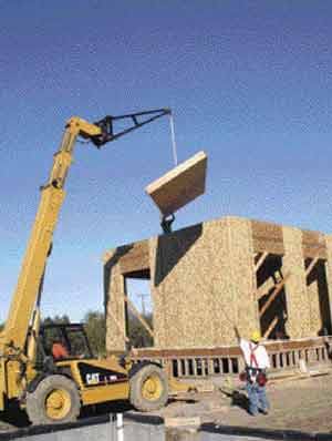

Handling. SIPs arrive at the site on one or more semitrailers. Small panels are light — a 4×8 6-inch panel, for example, weighs about 115 pounds.
Larger panels are heavy, so we rent an all-terrain forklift to handle those.

Setting Walls
Our panels arrive on the job cut to size with door and window openings, but without solid lumber inserted.
The foam is recessed along the edges, so there’s room to make insertions: bottom plates to fasten panels to the floor; splines to join them edge-to-edge; and top plates to stiffen the top of the wall and provide nailing for the roof or floor above.
We install these lumber members over beads of sealant (provided by the panel manufacturer), then nail them in place through the face of the panel.
For an extra charge, some manufacturers will install the nailers for you.
Plates. With SIPs, wall plates are nailed, screwed, or bolted to the floor and then the panels are slipped over them.
If the wall lands on a stem wall or slab, the plate and panel must be isolated from the concrete. To do this, we install a strip of pressure-treated plywood — sealed to the concrete with foam sill seal — and then install the plates over a bead of sealant.
Before installing the wall panel, we run sealant along the top and both edges of the wall plate, then stand the panel over it.
After bracing the panel plumb, we nail it to the plate through the OSB skin.
