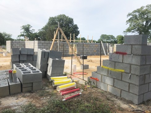

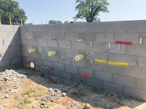

For example, we like to place PVC sleeves through the foundation wall for the trades to use later for rough-in. I typically review the details with the different trades on site to determine the best locations (unless it is obvious). Then, when the masons are working on a section near any of those locations, I provide the color-marked sleeves and stay close by to make sure the masons put the sleeves where I want them (photos below).
The author cuts appropriately sized PVC pipe sleeves to route the various utilities through the foundation wall and marks them with paint according to the color assigned to each trade.
He also paints coordinating marks on the CMU block wall to indicate to the masons where the sleeves should be installed as they lay up the wall.

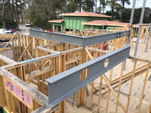

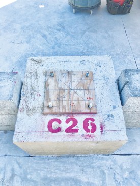

During the framing stage, I use stencils to clearly label steel locations so that when the fabricator delivers the steel, everyone knows exactly where it is supposed to go. This simple step can pay huge dividends throughout a build (photos below).
After the footings for the steel columns have been poured, the author marks them with a stenciled number that the fabricator uses to identify each member. The plywood template is marked with bolt hole locations and other information, and is also given to the steel fabricator.

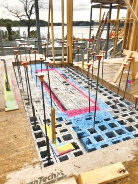

To help differentiate the elements in a complex fireplace installation, the author marked up the fireplace's block foundation with several different colors – again corresponding to each trade – prior to installation of the prefabricated firebox (in the area outlined in red).

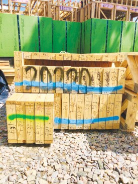

During this phase, it’s also helpful to know the duct layout as well as supply and return locations, especially if ducts will be run though the floor system. Marking the duct layout helps alert the framers where joists cannot be located, and where they will need to make adjustments to the layout (photos below).
As the interior walls go up, the author marks duct path locations on the top plates that coordinate with holes in the steel beams to ensure that joists do not get installed in those locations (above). A simple way to make sure that floor and ceiling joists are installed in their proper orientation is to mark the ends with a single color, though in this case the color doesn’t represent a utility (right).

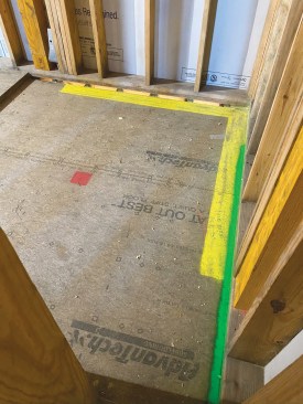

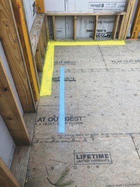

Before we shift into full rough-in, I mark on the subfloor any additional elements in the ceiling that other trades need to know (think of the subfloor as the reflected ceiling plan). These can include can lights, decorative lights, HVAC grills, shade pockets and shade locations against the windows, as well as all door swings (helpful when you’re placing switch boxes). I also like to mark shower drains (photos below).
Marking the location of a linear HVAC diffuser (in blue) and pockets for window shades (in yellow) on the subfloor helps the homeowners visualize their positions overhead.
In this shower area, the green paint marked on the subfloor indicates the location for a linear drain; it overlaps the yellow marking for a shade pocket that was later eliminated from the plans.

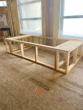

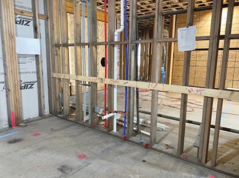

Visual aids. It can be helpful to provide a physical representation as a stand-in for a future architectural detail. This can be as simple as a 1×4 fastened to the wall framing to represent a countertop height. For a free-standing tub, a mock-up can quickly be fabricated out of scrap plywood to help properly position it as well as items that surround it (below).
To represent cabinet locations, I often cut leftover 1×4 or 2×4 stock to the length of the cabinet run (with countertop overhang accounted for) and screw it to the wall at finished counter height off the finished floor. Then I mark it with the cabinet layout, including sink centers and appliance locations.
A free-standing full-scale mockup of the planned tub was built to help the homeowners visualize different locations for the tub within the bathroom space prior to plumbing rough-in.
I know most cabinet suppliers are willing to come in and lay everything out on the floor, but their marks tend to become hard to see or disappear altogether. Plus, no one likes to lay out cabinets working from their hands and knees. Most important, working from the physical set point established by the stock screwed to the wall allows for the accurate placement of fixtures such as backsplash outlets, pot fillers, wall sconces, and under-cabinet lighting, instead of leaving it to the trades to guess where they should go (photo below).

In the kitchen, a 2×4 fastened to the wall at countertop height and marked with the cabinet layout provides a convenient visual reference for clients and a precise layout reference for tradespeople.
