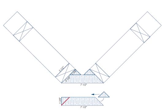

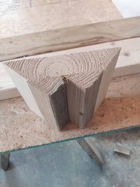

My simple, one-board, two-cuts solution creates an attractive outside clipped corner while preserving the 90-degree corner on the inside. I do this by making two 45-degree rips along the edges of a single 2×8, then attaching the rips to the narrower face of the 2×8, as shown below. With the rippings oriented toward the inside of the corner, this one-stud assembly can be used to replace typical two- or three-stud corners.

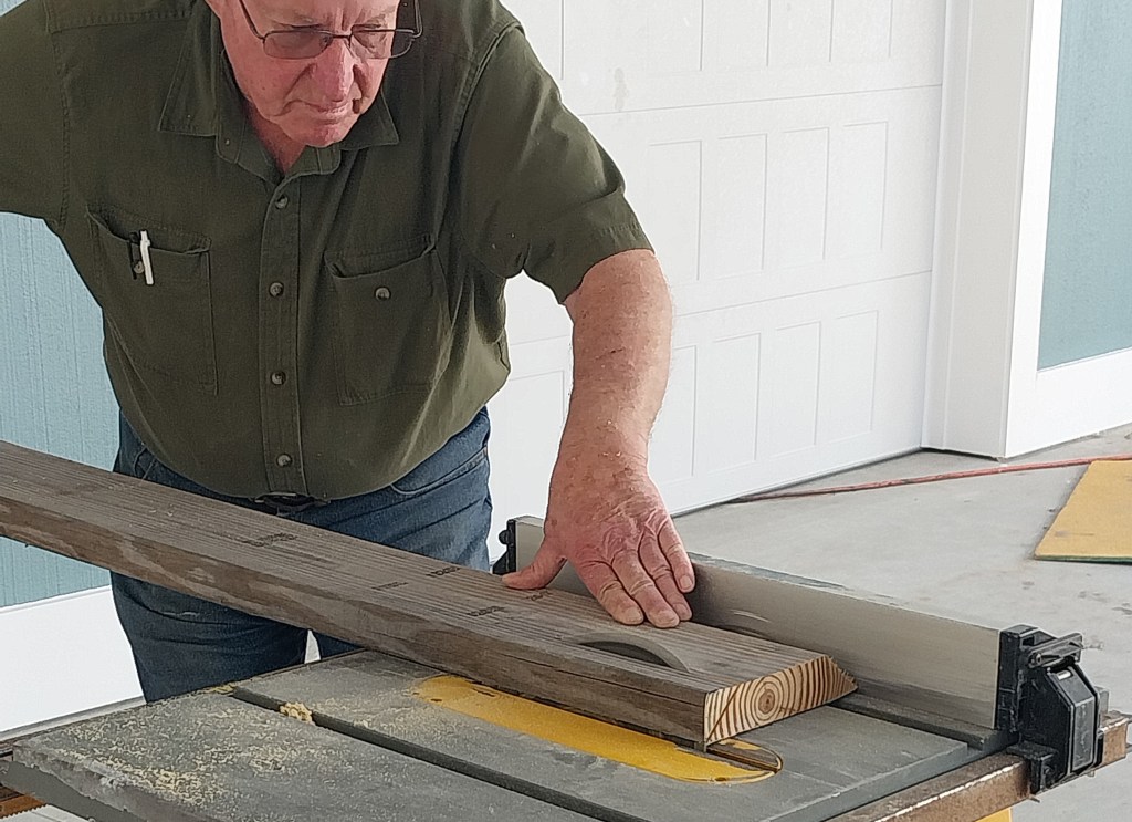

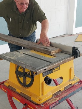

These bevel cuts are easy to make using either a circular saw or a 10-inch table saw, with a helper or other support to catch the rippings. The only trick to sizing the rippings correctly is to make sure that the kerfs run right down the middle of the edges of the 2×8. You are looking for slightly less than a 2-inch hypotenuse on the miter cut (see drawing, below).
To frame a clipped 45-degree outside corner while preserving a standard 90-degree inside corner where 2x4 stud walls meet at right angles, the author rips both sides of a 2x8 at a 45 degree angle to the dimensions shown in the drawing. Then the triangular-shaped rippings are nailed to the 2x8 to make the corner stud assembly, which he uses to replace the studs where the walls meet.
To frame a clipped 45-degree outside corner while preserving a standard 90-degree inside corner where 2×4 stud walls meet at right angles, the author rips both sides of a 2×8 at a 45 degree angle to the dimensions shown in the drawing. Then the triangular-shaped rippings are nailed to the 2×8 to make the corner stud assembly, which he uses to replace the studs where the walls meet.

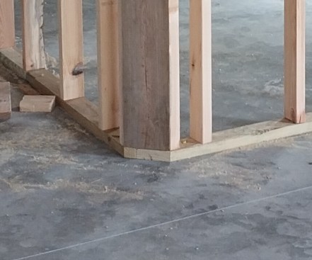

This detail requires that the wide corner stud merge with the two adjoining 2×4 walls, but there’s no real trick to laying it out. The top and bottom plates are run like a normal 90-degree corner, and once the new corner is installed, you simply cut the exposed points off with a reciprocating saw or flush cutter.

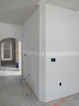

When it’s time to tape the drywall, plastic corner bead that opens up for the 135-degree angles is used to finish the outside corners. It’s a simple detail, but I’ve found that everyone who’s seen this architectural feature—including other builders—really likes it.
