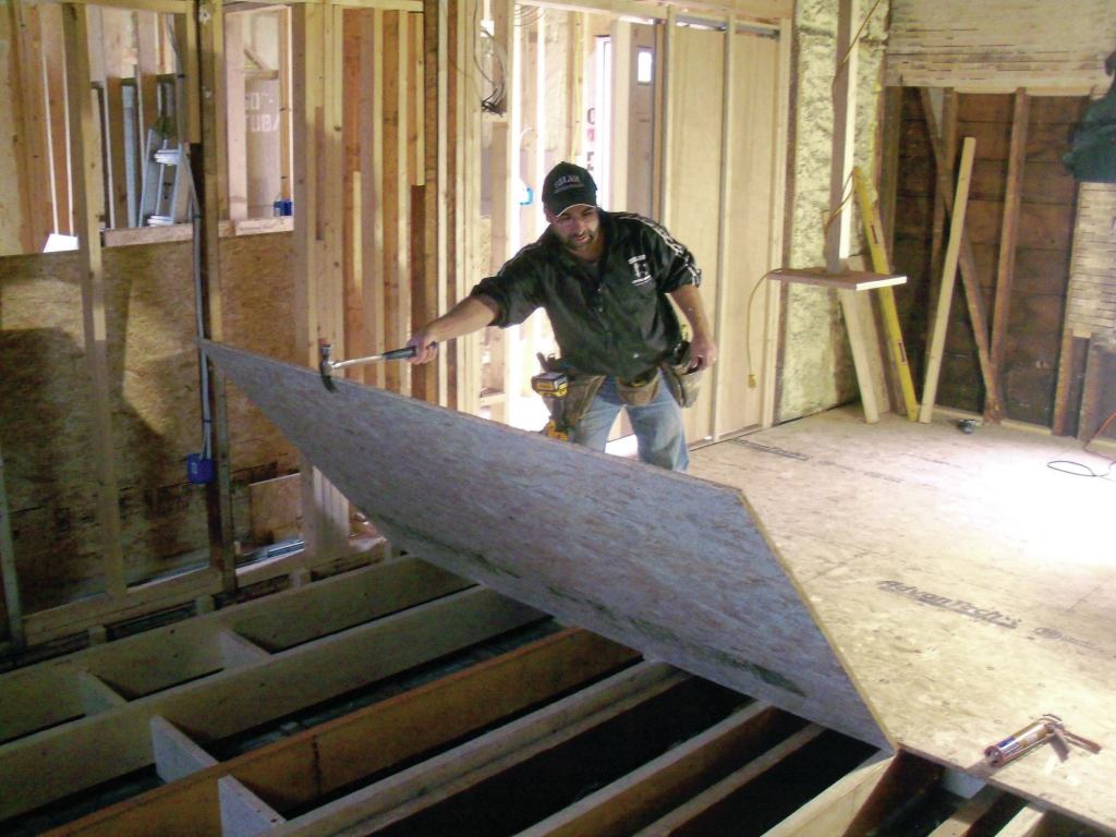

Finally, I insulated the ends of each joist bay against the outside wall with fiberglass batts. To complete the floor system, I glued and screwed 3/4-inch OSB subfloor to the joists, staggering the end seams as I went along (18). In the end, the extra time I spent paid off. The floor was completely flat, level, and solid as a rock—a perfect foundation for the new kitchen cabinets.

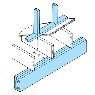

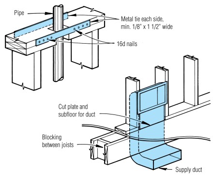

Metal ties are needed when a hole or notch removes more than 50% of a wall plate. Where mechanicals need to pass through a joist supporting a partition, double the joist with blocking in between to create a cavity (below).
Top: Metal strap ties are required when more than 50% of the plate has been removed. They are not required on the side of a wall that is fully sheathed with wood structural panels. Above: Joists supporting partitions should not be cut or notched to accommodate mechanicals. Instead, double the joist with blocking in between to create a cavity.
