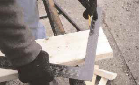

For accuracy, I use a framing square to lay out rafters. I use it initially to lay out a rafter pattern that contains all the necessary cuts for a particular set of rafters. I also use the Swanson Speed Square and the Swanson Big Twelve, a larger version of the Speed Square. But for my pattern layout, the framing square is key. It’s also the best tool to use when starting out, since it gives you a visual representation of the unit rise and unit run.
Ridge plumb cut. To lay out a full-size common rafter on my example roof, I first look at my cut list and check to see what length material has to be used. In our example, the 11-foot run and 2-foot overhang calls for a 16-foot 2x6. With the framing square, I mark the ridge plumb cut (first making sure the rafter is labeled with the crown up). I place the cut mark as close to the end as possible. Of course, if the wood is split, you move down to avoid it.
Once marked, I make this cut. Then, hooking the tape over the long point, I pull down the rafter the calculated length of 13 feet 1 3/4 inches and place a mark on the top edge. From this point, I make another plumb line as I did at the ridge cut. This line represents the building line — the outside edge of the wall.

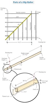

Hip Rafter Layout
A hip rafter is always cut from wider stock than the common rafter. This gives additional strength and allows extra width for nailing on the jacks. I make the ridge cut first. On a hip, the ridge cut is a little different from the commons because it must fit between two commons. This cut, called a double-cheek cut, has a 45-degree bevel on each side.

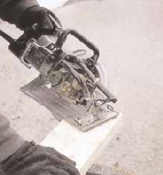

Cutting a double-cheek cut. To make a double-cheek cut, I place the framing square on the lumber so the tongue is set at 8 and the body is set at 17 (the run of a hip), and scribe a ridge plumb line down both sides of the 1 1/2-inch-wide tongue. Then, with the table of my saw set at a 45-degree bevel, I cut along the first (outside) line, making the long point cut. I leave the line intact. I then cut in the opposite direction along the other line, making a short point cut. Again, I leave the line. This maneuver results in a pretty good double-cheek cut.
Not a true 45. It’s important to note that this double-cheek cut is not a true 45-degree bevel, even though the saw is set at 45 degrees. Before power saws, this cut was made with a handsaw. But if a 45-degree line was made across the top of the rafter, and then cut with a handsaw, the resulting bevel cut would not fit properly. This is because the 45-degree bevel should be marked perpendicular to the ridge plumb line. This can’t be done laying a Speed Square or tri-square on the top edge of the board and drawing a 45-degree line. This also goes for the jack rafters.
Since modern roofs use 2-by stock and are cut with power saws, a carpenter can easily overlook this. But if you’re not aware of the issue, problems will arise when you use wider beam stock for the rafters, or when bevel cuts go beyond 45 degrees, as in the case of irregular roof jacks, turret jacks, and bay rafters. In these situations, the carpenter must understand basic rafter principles. For example, to lay out the ridge plumb cuts for a 6-by hip beam, I first scribe the plumb line as usual. Next, at a 90-degree angle from the ridge plumb line, I measure out the thickness of the stock (5 1/2 inches), and place a mark. I then plumb through this mark with another ridge plumb line, giving me two plumb lines 5 1/2 inches apart on the perpendicular. Across the top of the beam, I square two lines, one from the first plumb line and one from the second ridge plumb line. The intersection of two cross-diagonals between these two lines describes the proper bevel cut.

Hip Birdsmouth

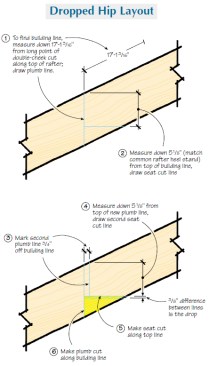

Once I make the double-cheek cut, I hook my tape over the end of the long point, measure down, and mark the top of the hip at the calculated length, 17 feet 1 3/16 inches. Here, I make an 8/17 building line plumb mark. This designates the top of the building line and marks the position of the birdsmouth. Next, using the same heel stand measurement that I used for the commons, I measure down 5 1/8 inches. At this mark, I draw a perpendicular (90- degree) seat cut line in the direction of the ridge. (When laying out birdmouths, always measure down from the top of the rafter. That way, if different widths of rafter stock are being used on the same roof, the tops of the rafters will plane in together.)
Dropping the hip. After I lay out the birdsmouth, I must “drop the hip.” This is done so the top edge of the hip will plane in with the other rafters. Because the hip rafter sits on the outside corner at a 45-degree angle from the other rafters, the outside face of the hip projects from the wall by half its thickness. If you don’t account for this, the top corners of the hip will stick above the roof plane. To correct for this, the seat cut must be cut a little deeper to drop the hip down.
To lay this out, I first measure along the seat cut line 3/4 inch (half the thickness of the hip), starting from where the seat cut line meets the building plumb line. I then draw a second plumb line that goes right through this 3/4-inch mark. From the top of this new plumb line, I measure down the heel stand of 5 1/8 inches make a mark, and draw another level seat cut line through this point going back towards the original birdsmouth. The 3/8-inch difference between the two seat cut lines is the drop for a 2-by hip on an 8/17 pitch. (This drop distance varies with the thickness and pitch of the hips, so this procedure must be done on each different roof.) The second (top) seat line is the actual cut line, so I scratch out the first (bottom) seat cut line and the second plumb line.

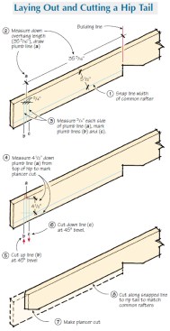

Hip tail cuts. Before cutting the birdsmouth, I lay out the hip tail. Because the hip is cut from wider stock, the tail that projects into the overhang must be ripped down to match the width of the commons. For now, I snap a chalk line on the tail part of the hip marking the new tail width, but I’ll hold off making this cut.
I first figure the length of the hip overhang. Using the Construction Master, I enter the 8-inch pitch, the 22 1/2-inch run (for the horizontal projection minus fascia), then hit Hip/Val, which will display 35 3/16 inches. I measure down the hip from the building line this distance and draw a tail plumb line. On each side of this plumb line, I mark half the thickness of the hip, or 3/4 inch, perpendicular to it, and draw two more plumb lines through each of those marks. This gives me a total of three plumb lines at the tail. From the top of the hip, I measure 4 1/2 inches down the original (middle) plumb line to mark the location of the plancer cut, and draw a perpendicular line in the direction of the birdsmouth. (Make sure the plancer cut line is drawn before the tail bevel cut is made. If you don’t, you have to measure down the center of the tail bevel, cut square over to the face, and then lay out a perpendicular fascia cut line).

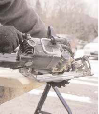

To cut the tail, I set the saw at a 45- degree bevel and make a double-cheek cut, just as I did for the ridge plumb cut. I cut down the furthest (outside) plumb line first, skip the middle line, and cut in the opposite direction along the third line. I then make the fascia level cut and finish off the tail by ripping the chalk line marking the width of the tail.

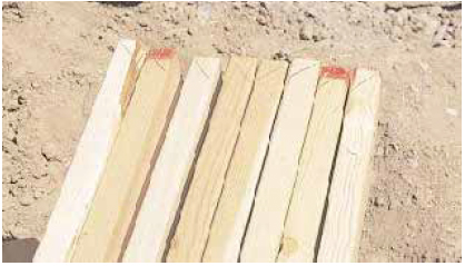

Because the jacks come in pairs and diminish in length as they progress down the hip, I stack the rafters in sets of eight, mark them for length, then scribe for the birdsmouth and tail cuts. In this method of production cutting, I add the tail length to each jack length to get a rough length for each of the various sets of jacks.
Starting with the longest jacks, I load up the sawhorses with eight rafters, crowns up. (If I’m using a cutting bench, I’ll place the whole set of jacks from longest to shortest.) I square up the ends so the rafters can be measured together, and designate the pairs of rafters by marking four with a diagonal slash from the top right-hand side and four from the top left-hand side. I hook my tape over the top of the rafter on the outside of my stack, and measure down 10 feet, 9 7/16 inches — the length of the first, or longest, jack — and make a mark for the building plumb line. I do the same to the outside rafter on the other side of the stack, then draw a square line connecting the two marks. I now have all eight of the rafters of that set marked for length.
I lay out each jack by laying it flat according to the diagonal mark I placed at the end — the diagonal slash indicates the long point and must face up. I use the rafter pattern to scribe the plumb cut, building line, birdsmouth, and tail cut. The tails and birdsmouths are cut just like those on the commons; the plumb cheek cuts at the top are cut with the saw set at a 45-degree bevel.
