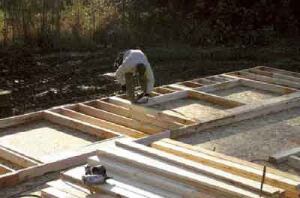

Laying out plates. I cut the plates in place, working to the snapped lines on the deck, and mark stud locations on them as I go. That way, if the other carpenters finish their tasks before I do, enough plates will be ready for them to begin assembling walls.
I cut the plates two at a time with a 10 1/4-inch Big Foot saw. If there’s time, I also cut the double top plate. If the wall is shorter than 20 feet, I run the plates full length; if it’s longer, I make the break at a 16-inch layout mark so that a stud centers on the joint.
On the plates that run through, I make a reference mark where they cross the intersecting wall, measure out another 5 1/2 inches, and then cut them to length. Later, when we assemble the wall on the deck, we simply align the reference marks to the snapped layout so that the wall is automatically square when we nail it together. We still check diagonals to be sure, but we rarely have to rack the assembly.
After cutting plates, I mark door and window locations, then use a layout stick to mark stud centers. On eaves walls (those that run perpendicular to the floor joists), I always put the first stud at a joint between sheets of subflooring; that way the studs stack over the joists. We do this as standard practice because it makes the building stronger, leaves open bays for mechanicals, and provides continuous nailing for metal straps.
An important part of the layout person’s job is to determine the most efficient order for framing and standing walls. The goal is to build as many walls as possible before standing any. I always start with the longest wall (usually the back one) and those parallel to it.
