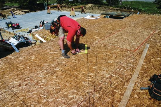

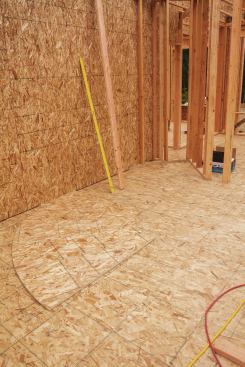

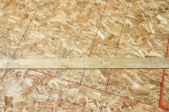

Using black chalk—so it's permanent and won't wash away in the rain—I snapped the stair layout at the same time as the rest of the wall layout. This allows some flexibility if we need to move things around a bit for a better fit and also helps shift my brain into gear.
To accurately lay out the stair, the "walk line" must be correctly located. According to the 2009 IRC (Sec. R311.7.3), the walk line should be 12 inches in from the inside edge of the stair, and the treads at their narrowest part on the inside curve must be at least 6 inches deep (R311.7.4.2). As long as you have a minimum tread depth of 10 inches at the walk line and no part of the stair tread is less than 6 inches, the code allows for a difference in tread depth between the straight section of the stairs and the winders. (Note: Under the 2012 IRC, the minimum tread depth has been increased to 11 inches.) If I needed to make things fit in a tight space, I could adjust the tread depth, but in this case I had a large, open area in the entry and didn't need to make adjustments.

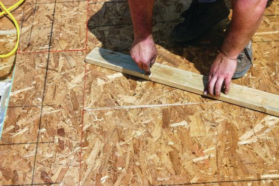

I began layout by snapping the line of the top riser, which was also the edge of the top landing. Next, I found the radius as defined on the plans, and made a trammel from a piece of strapping. I put four marks on the trammel—the outside distance from the center; the inside curve (both sides of the 2x4 wall); and the walk line 12 inches from the inside end of the tread—then used it to draw the edges of the curved section of the stairs. With a square along the top riser line at the walk line, I marked 10 inches in front of the top riser and snapped a line through this mark for the next riser. I repeated this, sliding the square until the 10-inch mark touched the walk line, snapping a new line for each riser.

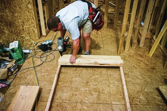

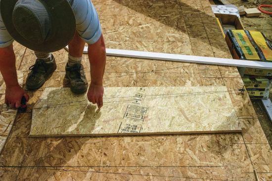

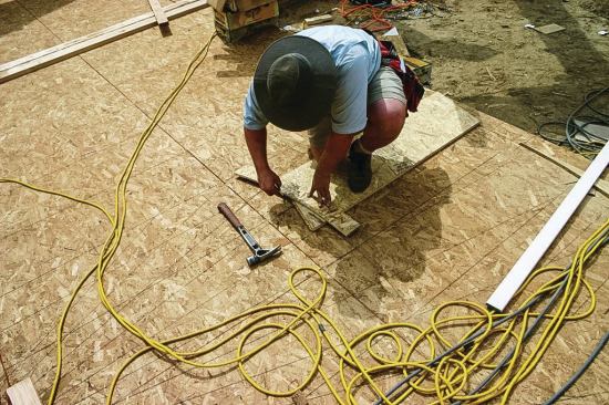

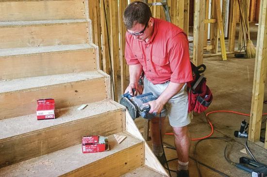

The next step was to physically scribe each tread directly over the marks on the floor and then set the cut treads on their marks. I marked each tread with a number and put that number on the floor so I'd know what goes where, making sure that the treads are cut perfectly to ensure that each step lines up correctly and follows the layout. I also cut 2x12s for the risers (using good-quality Doug fir or LSL) and the 2x4s that will serve as the cleats each tread will be fastened to, and set these in place on the snapped-out layout as well.

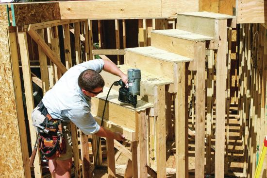

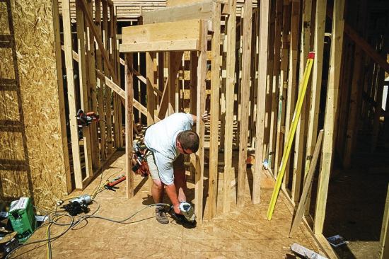

Next, I cut the pair of 2x4 "legs" for each stair. I set the story pole over the pair of 2x4s, marked the length (height) for each riser, and cut the pair using the Big Foot saw so that they're an exact set. I marked each pair to match the corresponding tread label marked on the subfloor.

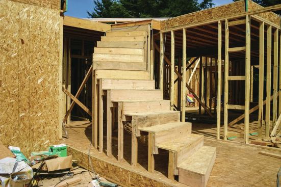

With everything cut and ready to go, I began gluing (with PL Premium) and nailing a 2x4 cleat to each 2x12 riser, then gluing and nailing this assembly flush to the top of a pair of 2x4 legs. It's easy to nail the 2x12 to the 2x4 legs, then stand the assembly up and toe-nail the legs directly to their corresponding marks on the floor.
Before moving onto the next set of legs, I glued and nailed the tread to the previous riser cleat, locking each step in place. At each step, I'd double check for plumb to make sure I was staying over the layout on the floor. By starting at the top and working down the run of stairs, I always had something solid to nail into and I didn't need to brace the stair at all. (Depending on the stair width, some additional 2x4s may be needed along the outside wall supporting the stairs so that the drywall J-channel has enough support to make a smooth curve.)

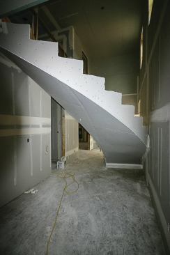

Free-standing Stairs

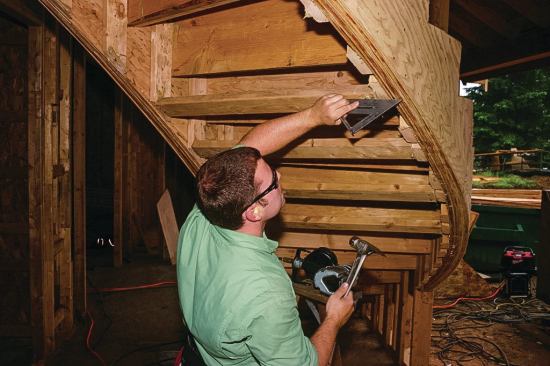

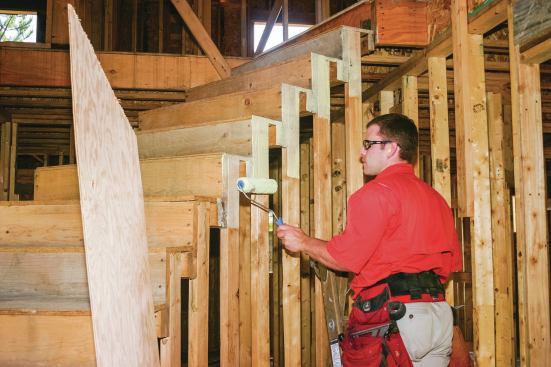

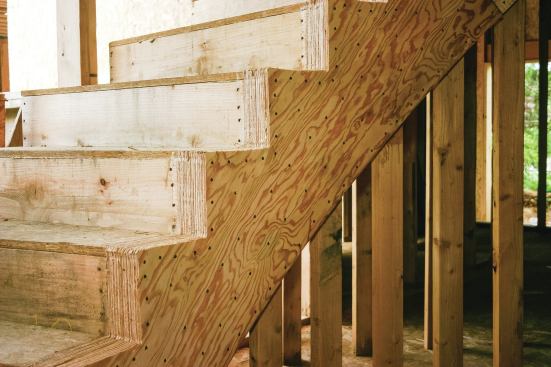

We build free-standing stairs the same way, but add a load-bearing laminated stringer from many layers of 1/4-inch plywood, then cut away the supporting 2x4s.
To make the laminations, we cut 16-inch rips, then generously apply Titebond II with a paint roller. We glue and staple the first layer onto the studs, then use the paint roller to completely coat each subsequent layer of plywood with glue before stapling on a new layer. We rout out the tread and riser profile in each layer as we go. For the stairs shown here, we installed a total of 14 layers, nailing through the last layer with a framing nailer to make 3 1/2-inch–wide structural stringers.
We let the glue dry for a week before cutting the 2x4 legs flush with the underside of the laminated stringer. To test stiffness, we had our heaviest guys bounce around on the outside of the stair. It deflected about 1/4 inch along the walk line with almost no vibration at all.
The sides of the stringers and the undercarriage were finished-out in drywall before the hardwood treads and handrail were installed by the finish crew.
