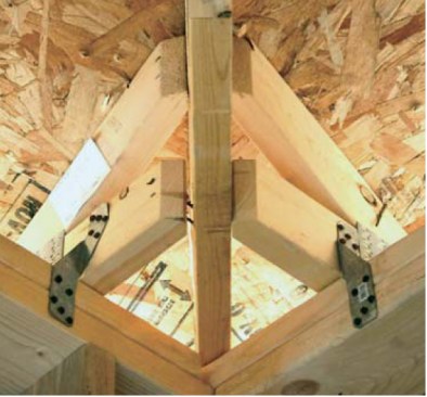

The framing carpenter on this job also failed to provide adequate bearing under the ends of a couple of trusses (above ). Instead, the trusses bear on an interior partition wall, resulting in cantilevered truss ends that "float" above the wall plate. Unfortunately, they won't float for long.

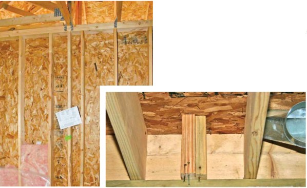

A girder truss is engineered to support heavy roof loads and carry them to the points where the girder bears on the wall plates. These significant point loads need to be directly supported by columns with sufficient strength and stiffness to transfer the loads to the foundation wall. In this project, the point loads should have been borne by — at the very least — doubled 2-by posts properly nailed to both the top and bottom plates, not by a single loose stud propped into place (below left).
Adding to the problem, load-transfer blocks below the girder truss support on the upper floor hadn't been cut to fit properly (below right). Because they are too short and not tight to the subfloor, they will allow the wall plates and truss support columns to settle, which can result in cracked drywall and possible structural damage.

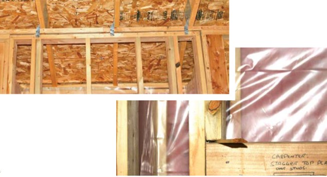

Wood is strongest when loads are applied parallel — rather than perpendicular — to grain. White cedar shims, of course, are made from a light and porous wood and are cut with the grain; they simply don't have enough compressive strength to be used in structural applications. On this house, the framing carpenter improperly used them to fill in gaps between the top plate and a header wall for a fireplace (below left), and between load-bearing studs and the lintel header (below right; note the state building inspector's drawing indicating the proper framing for this wall). Under normal roof loads, the fibers in these cedar shims will be crushed.

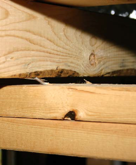

An important part of the framer's job is to install proper blocking. On this house, none of the rough openings for bath fixtures had any blocking, and some of the ceiling blocking was either missing or loosely nailed in place (below). Such gaps can lead to movement, and then cracking of the drywall.

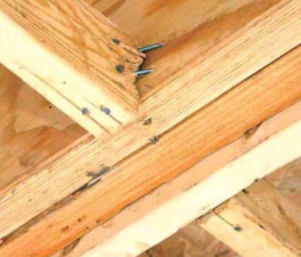

It's also important not to overnail a framing member. For example, this porch ceiling joist (below) has about 10 toenails shot into it, which shredded the end of the 2x4. Without a joist hanger to hold the pieces together, there's no way this joist end will be able to support the weight of the ceiling.
