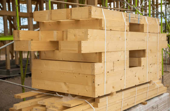

All eight were filled. There was literally zero room to spare, each smothered with hundreds of carefully-bound and packaged engineered wood structural posts and beams, some weighing as much as 2,000 lbs. By design, they each were to unload in a particular sequential order once they landed at BMC’s North Las Vegas distribution facility.
That sequence fit an even grander color-by-numbers design. As each separately-packaged cluster of building members came out of one of the shipping containers, the crew unloading the containers noted that every one of them carried a number. Each number corresponded, in turn, to a single position in the blueprint of the home, that further, tied to engineering documentation where every one of the home’s parts and pieces came out of the Kanto factory in Japan and would navigate 3,000 miles to its proper spot in the 5,400-foot structure, with millimeter precision in the new Chōwa—Living In Balance house.

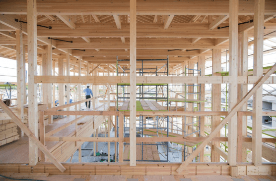

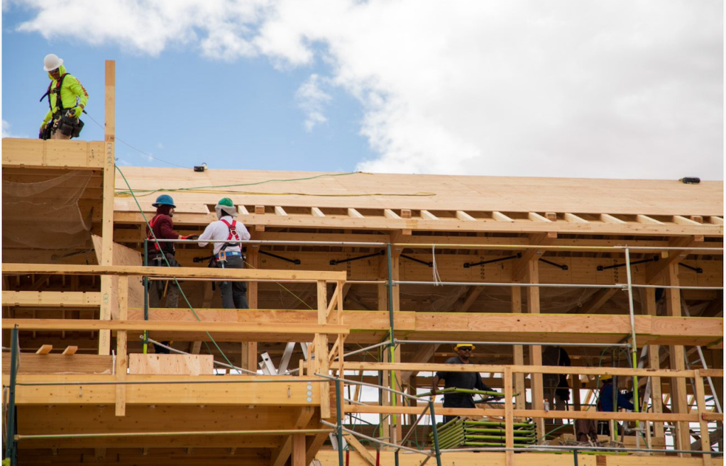

  • … for a building that a team of framers never before encountered the likes of, but which they completed from “sticks-in-the-air” to the start of nailing down the roof in eight-and-a-half days, not counting a couple of days lost to high-wind delays.
If the crew members proceeded as instructed by the numbers, and staged each cluster by following the proper order at the distribution center, they could forward the pre-engineered materials—a proprietary post-and-beam enclosure from Sekisui House’s Kanto facility—to Sekisui House operating unit Woodside Homes’ building site in the Talon Ridge neighborhood of the Las Vegas-area Summerlin Master Planned Community, exactly in the order of on-site assembly.
By the time BMC’s trucks arrived at the building site, Lot 17897 at Hawkeye Lane, in Summerlin’s Talon Ridge, and crews—supervised by Sekisui House construction site specialist Shigeyoshi Morishima and construction department manager Shotaro Kumazawa—staged out the first load in the delivery, local American, mostly Spanish-speaking framing crew members knew this job was going to be different than anything they’d done before.
“This is a custom home, and our crews’ experience up to this point has been just about 100% production volume building, much smaller, simpler home designs,” says Las Vegas BuildWithBMC market framing manager Rudy Castro. “Our guys had never done anything like this before, but with the Japanese team member helping and the way those materials were labeled, they picked up the gist of it and were putting pieces together within a couple of hours.”
Three stark realizations occurred to those supervising the project, whose customized building enclosure with kit pieces were never assembled in precisely this way in the United States before, went from foundation to the start of roof nail-down in eight-and-a-half days, with six workers and two Japan-team members orchestrating the process:
  1. No circular saws. No cutting on-site was necessary, as every structural detail had been pre-built digitally, and then physically in the Kanto, Japan, factory.
  2. Tri-lingual job site. English, Japanese, and Spanish were spoken on the site, and despite many common terms and interpretations getting “lost in translation,” what translated perfectly was how to follow the numerical, labeled system of positioning, orienting, fastening, and connecting each post to its pre-designated location and orientation (with the SHAWOOD branding invariably facing the front of the building—think of a massive Ikea project—and each beam fitting perfectly where it had been designed, engineered, and factory-cut to millimeter precision in Japan.
  3. Velocity. Not simply speed but, rather, speed with accuracy, productivity gain, and profitability from a building system both precisely executed and easy to implement.

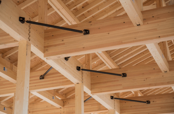

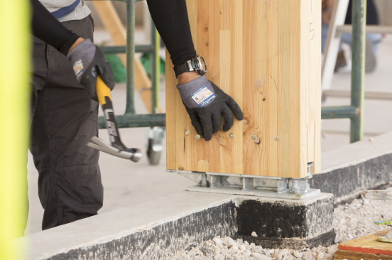

Importantly, what differentiates the SHAWOOD post-and-beam framing system from typical enclosures built in the U.S. is the way that the structure handles lateral load capacity to the foundation. This difference—developed under conditions of severe stress and shock to structures in Japan from both wind shear and seismic activity—causes buildings to safely endure such stresses and shocks, but not exactly the same way most U.S. buildings do.
While most structures in the U.S. gain lateral load capacity through a firm, solid, and continuously direct connection to the foundation, the proprietary SHAWOOD system anchors each post to a metal, shock-absorbing stand whose “fin” slides into the post like a sleeve before bolting in place.
“When we were all said and done, even with the limited contact to the foundation, the Sekisui House system has capacity at least up to U.S. code to ensure we can absorb different forces that stress lateral load capability,” says Kent Barber, senior VP at L.R. Nelson Consulting Engineers. Barber actually converted the entire Sekisui House-SHAWOOD structural engineering system into terms U.S., state, and local code and inspection officials could understand and approve as equal to or even superior to U.S. building codes. “The difference is, whereas U.S. frames rigidly lock to foundations to ensure that lateral load capacity, the Japanese system is designed to rock and give, and then fall back into place.”
SHAWOOD’s track-record for performance amidst seismic shocks and stresses provides evidence for Kent Barber’s case that the technology would stand up to adverse conditions in the U.S. market equally well. After a magnitude 6.9 earthquake hit Kobe, Japan, in 1995, no SHAWOOD houses were lost. Likewise, even the massive 9.0 earthquake that struck in northern Japan in 2011 did not collapse SHAWOOD homes—although the resulting fatal tsunami took its toll on some of them.

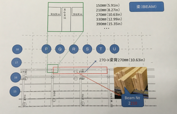

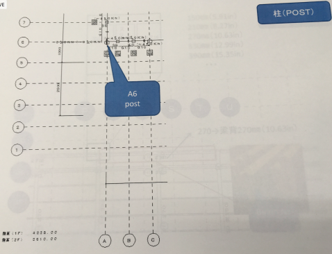

The entire structure is set up on a X and a Y axis, Salerno explains. Each X axis location has numbers, and each Y axis location has a letter.
“The Japanese supervisors divided us into two groups, front of the house and back of the house,” says BuildWithBMC’s Kenny Anderson. “From 1 to 370, and from A to Z. They told us it would take our crew of 6 up to 15 days to complete the frame, but you see we got it done in a little over half that time. Before this, none of my guys had ever framed anything like this. They were proud to work on this project.”
