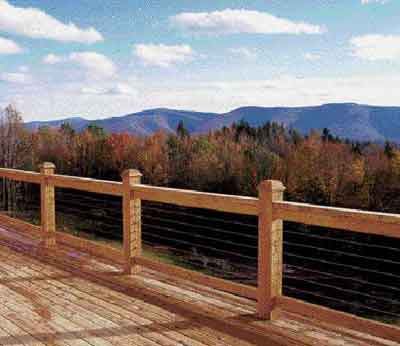

Stainless steel cable railing is low maintenance and long-lasting. It’s also fairly easy to install: Horizontal cables are strung through holes drilled in railing posts and tightened with cable studs — fittings that grip the end of a cable run and allow it to be tensioned —until they “sing.” With its open, airy design, cable railing virtually disappears, providing an unobstructed view and a clean, contemporary look.
My company specializes in building decks. Though cable railings don’t make up a large percentage of our work, we have seen an increase in demand for them since they were approved in recent versions of the building codes. Many customers ask about cable railings but lose interest after learning that they cost almost twice as much per foot as wood ones.
I buy cable in bulk and have the fittings I need made in a local millwork shop. This substantially reduces my material costs compared with using an off-the-shelf cable-rail system. For convenience, however, you may want to consider one of the available packages if you’re doing only one deck (see “Buying Components”).
