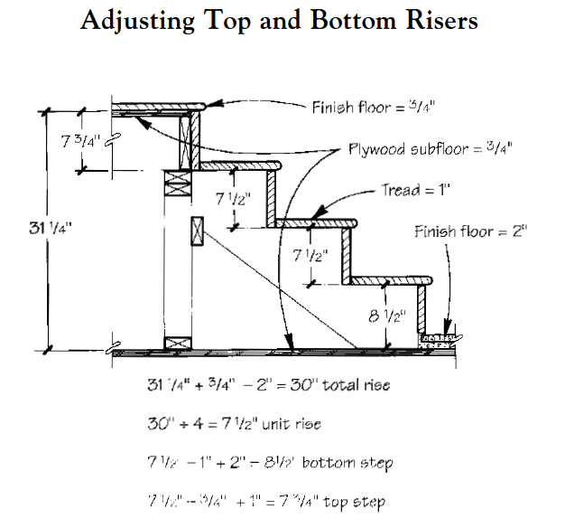

When treads and floor finishes differ in thicknesses, use the formulas shown to adjust the height of the top and bottom of the rough carriage.

1. Find total rise. Measure the distance from subfloor to subfloor. If the finish flooring materials differ in thickness at the top and bottom of the stairs, use the following formula:
Total rise equals subfloor-to-subfloor measurement plus thickness of second floor finish minus thickness of first floor finish.

4. Adjust top and bottom risers. If floor finishes are different thicknesses at the top and bottom of the stair, you’ll need to adjust the top and bottom risers. Use the following formulas: (see illustration, above).
Bottom riser: The distance between the first-floor subfloor and the first level cut in the carriage equals unit rise minus tread thickness plus thickness of the first-floor finish.
Top riser: The distance between the top of the second-floor subfloor and the last cut on the carriage equals unit rise plus tread thickness minus thickness of second floor finish.

Be aware that errors in layout and construction are additive. Under my local code, the rise and run of adjacent treads may vary no more than 3/16 inch and the maximum variation between any two treads over an entire set of stairs is limited to 3/8 inch. So if the first 16 risers on a 17-riser stair are each 1/32-inch short, the last riser will be off by 1/2 inch — a code violation. I check my layout by marking the total rise on a board, setting a compass to the unit rise, and walking off the correct number of risers on the board. If the math is correct, the point of the compass will start on one mark and end on the other.
