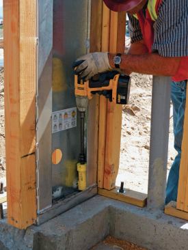

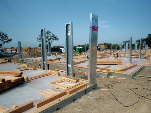

Typically, framers set the shear-wall panels directly on the concrete foundation or on the first-floor frame before they start stick-framing the surrounding walls. Kerr describes the installation process: "You form for your concrete (we do most of our own concrete work), you get all your rebar in, and you get a set of drawings from your engineer. All the panels come with a template, and you attach the template to the forms. Then from the template, you hang off your threaded rod or your anchor that is going to get embedded in the concrete in the forms. You just have to follow the instructions. … Once we've poured it, it only takes two guys a couple of hours and they're in. Then you just frame around the thing and attach it."

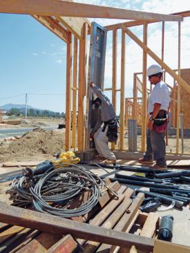

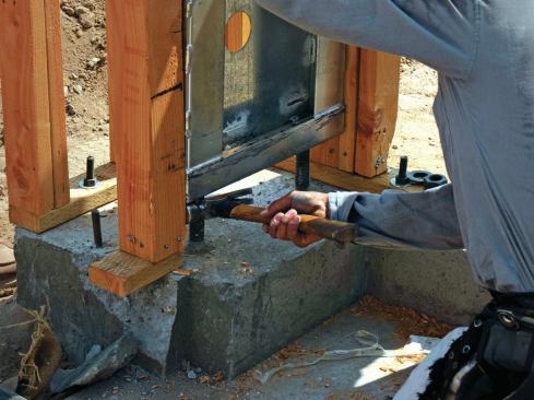

Sometimes, however, because of delivery issues or job schedules, wall framing is completed before the panels are installed. You can set a shear-wall panel into an already framed wood wall, but it may be a little fussier and slower (see photos, next page), so framers usually prefer to set the panels first.
"Probably the most critical thing is to get the bolts in the right spot to start with," Gordon says. "You have to use the templates. We've had bolts misplaced a couple of times, to where the panel is sitting outside of the wall."
Kerr agrees. "You better do your layout carefully, and be sure you've looked at all your framing members so that you've given it enough space to fit, you've put it in the right spot, you've set the template just so, and you've set the right bolts and hardware in place. If you blow it there, you can take care of it, but that's only going to cost you time and money. If you missed a bolt, you have to drill a new bolt and epoxy it in. If you've got something in the wrong spot, well, you might be chopping the whole thing out."
That happened more when the products were new and unfamiliar, says Simpson Strong-Tie's Don Simon, a trainer who helps manage the company's builder education outreach. "In the early days, we had guys in the field all the time helping builders fix mistakes," he says. But these days, it's old hat, at least on the West Coast.
