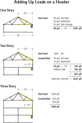

We’ll look at one-story, two-story, and three-story houses. A single-story house with a standard pitched roof has two eaves sides and two gable sides. The weight of the roof usually bears on the eaves side, particularly when trusses are used, and the loads here are more severe than the loads on the gable side.
Consider a fairly wide house, say 40 feet (see illustration below). In most of the country, snow loads are less than 40 psf, roof structure with trusses and insulation is about 20 psf, and the attic is loaded to 20 psf. Each eave supports half of the roof load: 20 feet of roof, for a total of 1,600 pounds per lineal foot on the header. The two-story house analysis assumes the worst case for the second story: that the floor joists run perpendicular to the wall and are 20 feet long. With a code live load of 40 psf, a structure load of 15 psf, and 100 pounds per lineal foot added in for exterior wall (studs, sheathing, and so forth), the header load in a two-story house becomes 2,250 plf. The loading from a third floor would bring the load on the header to 2,900 plf.
These sketches illustrate the loads on a typical eaves-side header in a 40-foot-wide house. As long as the loads on your header are equal to or less than these, you can use the chart on the next page to size the header.

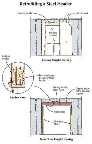

STEEL ANGLE HEADERS
5′
6′
8′
One-story
L6 x 3.5 x 3/8
L6 x 4 x 5/8
L8 x 4 x 3/4
Two-story
L7 x 4 x 3/8
L7 x 4 x 3/4
L8 x 4 x1
Three-story
L7 x 4 x 1/2
L7 x 4 x 3/4
Nothing fits
You may want to keep the original window header in place, because ripping it out could cause more disturbance to the exterior finishes than necessary. In that case you could use a steel angle under the header, extended to the width of the doorway, as shown in the illustration below. It’ll still take some chopping to fit in the angle, and since angles are extremely inefficient as structural beams, you’ll need a fairly hefty angle (see the table above). Still, in some cases it might solve your problem more easily than a tube or a glulam.
In some cases it may be faster to retrofit a wider header while leaving the existing header in place.
