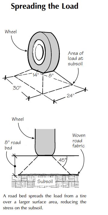

A “road” is no more than a device to spread out these wheel loads onto more surface. Since the load is on a larger area, the stress goes down. The vehicle stays on top, without sinking in.
The simplest way to make a road is to lay down 8 inches of gravel. The gravel should be compacted, packed tight to increase the density. This is often done with the crawler that is used to spread the gravel along the roadway. The crawler is run back and forth a few times over the “lift” or layer of gravel until the gravel tightens up.
The 1,000-pound load from each wheel of our truck sits on the top surface of the gravel, but the load spreads out through the gravel at about a 45- degree angle, as in the sketch at left. The bottom surface of the gravel presses on the soil, but because of the 45-degree spread angle, this surface is 24x30 inches, much larger than the footprint of the tire. This larger surface places a stress of only 200 pounds per square foot, far below the squishing threshold (soil strength) of the ground.
There is a secondary positive effect of placing gravel, and that is to dry out the soil below. The gravel covers the soft subsoil and carries the surface runoff away. The subsoil is now dryer and somewhat stronger than the waterlogged surface would be. So our road will take on slightly heavier vehicles than a light truck, and we’re in paradise.

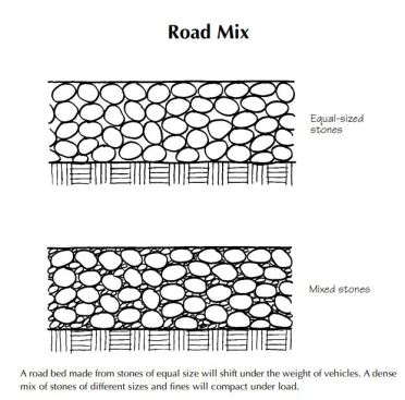

The first thing is to create a denser roadbed so that individual stones do not feel the wheel loads. This is done by preparing a gravel mix consisting of large (2-inch) stones, smaller stones (3/4-inch), and “fines” — particles smaller than 1/64 inch (or (0.00004 microns).
The sketches on the left might help give an intuitive idea of the compaction of a gravel mix. In the top sketch, there is a void among the circles, representing stones of a consistent size, that cannot be filled. The second sketch shows smaller circles in the voids, a far denser mix. This is the classic Macadam road, where a top layer of fine gravel is placed on the base layer of coarse gravel, and the fines are swept or washed into the larger stones of the base.
Then we get to the next problem, of the hard stones slipping against one another. There is no grip and the vehicle tires just toss the stones away. A proper mix of stone sizes helps to control this slipping, but often we have to add something to our mix to bind it together. This is usually a pulverized clay or sometimes even organic topsoil, maybe a cubic yard to each 4 yards of gravel.
