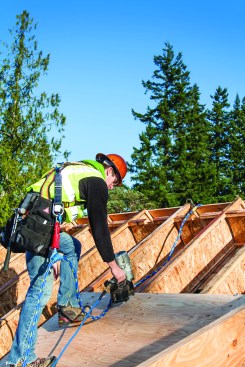

The Super Anchor Safety Max X-Line combines an air hose with a fall line.
Tim Uhler The Super Anchor Safety Max X-Line combines an air hose with a fall line.
There are a ton of choices, at many different price points. Here I’ll review a few basic harnesses, as well as some of the more “deluxe” gear that works for us as framers. But I encourage everyone to scout out the market to find what works for his or her particular trade.
Super Anchor Deluxe. This harness has been designed to be comfortable and functional. It sports attached nail bags, which is nice, but the bags are pretty typical and not necessarily “framer specific.” (I found them to be too deep, and it was difficult to put my tape back into its pouch, which slowed me down considerably.)
The shoulder and the back straps are extremely comfortable. They are padded, and the straps don’t have any edges, as they do on the basic harnesses. In addition, the straps are designed not to absorb too much moisture—a big advantage in wet climates like ours or in hot climates where the harness could absorb sweat and begin to stink. All the connections are quick-connect, and replaceable webbing keepers hold the extra length of strap against the frame of the harness.
This harness has nice features to aid in inspection. It has tags that show where to inspect for wear and also a tag behind one of the straps where you can keep a record of the inspections.
I enjoyed wearing this harness. The only complaint I have (besides the nail bags) is that the chest strap can be adjusted only narrower or wider; it can’t be adjusted up or down. After a couple of hours, I found that my nipples were sore (and as I complained, my crew laughed at me). If I could adjust the chest strap, I would use this rig and just replace the bags with the style of Occidental bags that I like.
Online, this rig sells for $360. This is a lot to spend, but look at it this way: It keeps you safe and doesn’t wear out as fast as boots, so you will get quite a few years out of this rig. You can buy the ultra hi-vis version without the bags for $274.

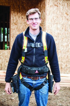

The Exofit Nex harness has a lot of features, like trauma straps to relieve pressure if you do fall.
Tim Uhler The Exofit Nex harness has a lot of features, like trauma straps to relieve pressure if you do fall.
Exofit Nex. This is the most feature-rich of all the harnesses we tried. The shoulder and leg straps are extremely well-padded. The shoulder pads have a protective covering, so the straps don’t wear if you carry things on your shoulders. The leg straps are adjusted using quick-connect buckles that can be locked. The same style buckle connects the chest strap too.
The rear D-ring is spring-loaded so that it points “up” toward the head. This makes it easier to click in your lifeline, especially if you aren’t very flexible, like me. The torso straps have “revolver”-style adjusters, where you twist a knurled knob to lengthen or shorten the strap, and then the adjuster locks the strap in place.
The webbing is water repellent and the shoulder pad has straps for storing the hook on certain styles of lanyards. This rig also has “trauma straps.” If you do fall, you can put your foot into these straps and lift yourself up to relieve the pressure. This helps relieve circulation problems caused by dangling until help arrives.
To help keep track of inspections, this rig is fitted with an RFID device so that inspections, assignments (who has what harness), and inventory can be done on a computer.
With all of these features—and a hefty price tag ($360)—is this a harness worth buying? One guy on my crew really liked this rig and felt it was very comfortable. I loaned one out to a female friend of my mine who wore it roofing, but she had the same complaints I did: We both found that the fit was comfortable, but the trauma strap interfered with the nail bags. I didn’t like the extra pockets on the shoulder straps. Overall, this rig felt big and obtrusive.
In my opinion, in order for a harness to be worn, it needs to be nearly invisible in use, or guys will just get bugged and not want to wear them.

While I loved the Super Anchor Deluxe harness rig (with tool bags—like Occidental pouches—that are more to my liking), the chest strap couldn’t be adjusted to fit my stature. Still, of all the harnesses, it is perhaps the most comfortable and simple to use. In addition to that rig, I recommend the Werner Blue Armor 1000. That harness was easy to put on and take off, comfortable, and brightly colored; in addition, wearing my Occidental framing bags over the harness gave me no problems at all.

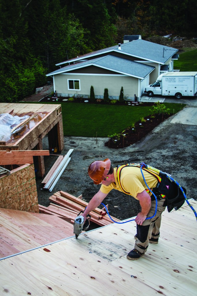

Easy to set up, the Super Anchor Safety Bar provides a legal tie-off point for two workers.
Tim Uhler Easy to set up, the Super Anchor Safety Bar provides a legal tie-off point for two workers.
Key Elements
Complying with fall-protection rules can be difficult if you can’t find a safe anchor point. In some situations, it’s nearly impossible to properly rig a lifeline. This is particularly true for us when we’re rolling trusses. Fortunately, I recently discovered a solution—Super Anchor’s Safety Bar.
The Safety Bar is very easy to set up: Just slip it over the top chords of three trusses, pop in the detent pins, and then put a couple of nails through the 1/8-inch holes in the bar to keep it from sliding. As long as the trusses are braced, you now have a legal tie-off point for two workers (provided neither weighs more than 310 pounds). As a bonus, the bar holds trusses on layout, too. For our crew, I think we’ll buy another bar or two the next time we frame a big house. I looked online and found them for sale for between $280 and $380. That’s not cheap, but it’s a whole lot less than the fine we face for framing without proper fall protection.
