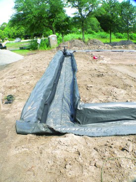

Superior Walls delivers and places foundation and upper-story walls as a turnkey operation. But the builder is responsible for site work and for providing the footing. In most cases, we use a gravel footing: a trench lined with drainable geotextile filter fabric, filled with crushed stone, and roughly leveled, with a perforated perimeter drainage pipe in a filter sock. If we build in a coastal V zone (“velocity zone”), where a hurricane storm surge might scour the soil and undermine the footing, we use deep-driven pilings and a grade beam foundation. But this house was only in the A zone, so a gravel footing was fine.
If I’m building in an area that is known to have soils with a bearing capacity greater than 2,500 pounds per square foot (psf), I can size my stone footing to a standard dimension from the code. But for this house, we were building near a river on silty sand with bearing strength of about 1,500 psf, so I had an engineer test the soil and specify the footing size.
The concrete base of a Superior Walls panel is 10 inches wide. With a gravel footing, the load-bearing capacity of the stone spreads outward and downward from the wall base at a 60-degree angle. The engineer specifies a footing depth that is sufficient to reach adequate bearing width for the soil conditions on the site. As the builder, I place the gravel according to the engineer’s drawing and roughly grade it.
We use 1/2-inch crushed stone, called “78 stone,” for our footings. Occasionally I’ve used 3/4-inch “58 stone,” but it’s harder to spread and compact, and it doesn’t add any significant strength.
When the Superior Walls crew arrive, they compact and level the stone bed to their satisfaction using a laser, grade stakes, and an aluminum straightedge.

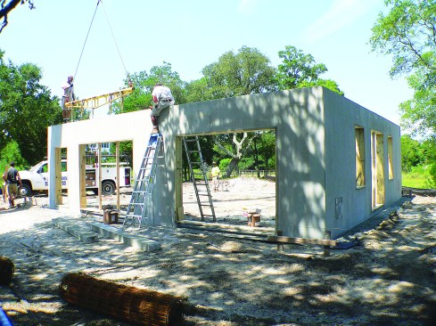

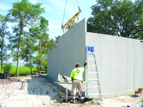

SETTING WALLS

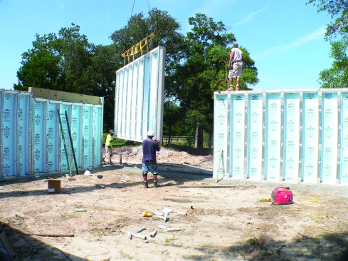

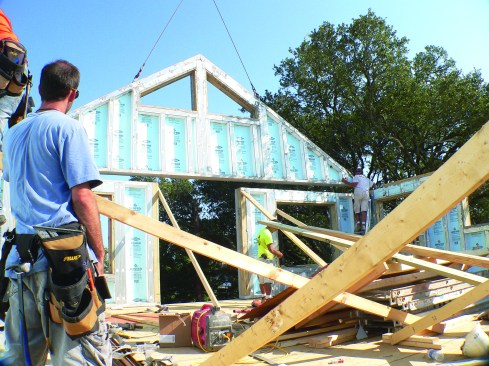

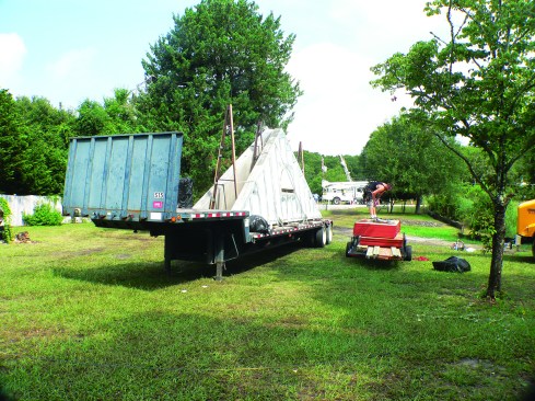

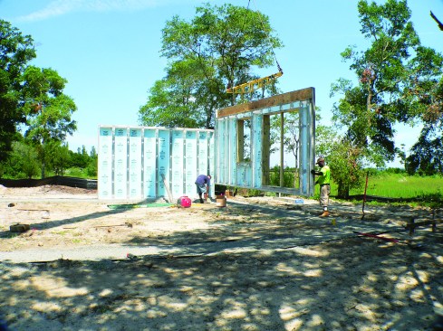

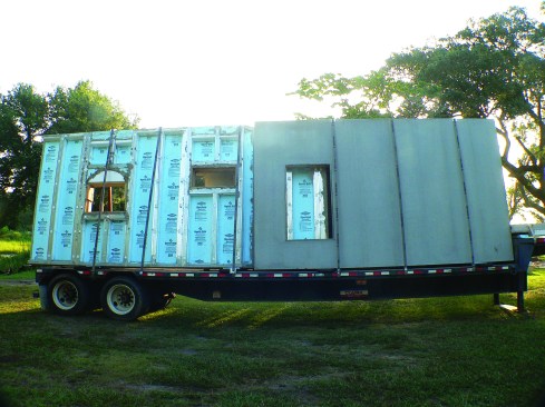

When they’re happy with the footings, the Superior Walls crew start to lift panels off the trailer with the crane and swing them into place. I provide batter boards and strings to guide the placement. I’m always on site for the set, and it’s impressive to see the crew swing those 8,000-pound panels down and just kiss that string with so much precision you’d think they were doing surgery.
They start by establishing one corner and making sure it’s perfectly plumb. That first corner pretty much determines the rest of the panel positions.
The joints between the panels are sealed with an industrial-grade urethane-based sealant. At wall corners, the panels are bolted together with through-bolts. At in-line connections, the panels connect with a preformed lap joint, which is fastened using a bolt and a steel fitting.

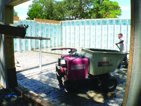

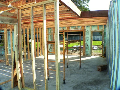

Setting the walls for one story typically takes about half a day. The next step is to finish prepping the ground inside the wall system for the poured slab. This slab is a key component: The concrete flows inside the wall cavities and locks the whole assembly together. All of the usual components—including the ground vapor barrier, steel reinforcement for the slab, interior footings, plumbing, and electrical—are required, just as with any other slab on grade.

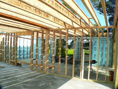

Once the slab is poured, framers can then construct any load-bearing interior walls and columns, and frame the first-floor platform within the Superior Walls perimeter. This should take only a day or two. Meanwhile, the next level of walls that have been cast at the Superior Walls plant is en route to the site.
Upper-story walls require less preparation, since there isn’t any groundwork involved. Three to four hours on site with the crane, and the Superior Walls crew is gone again. My framers are immediately back at work building the next level of interior walls, and building another floor frame or a roof.

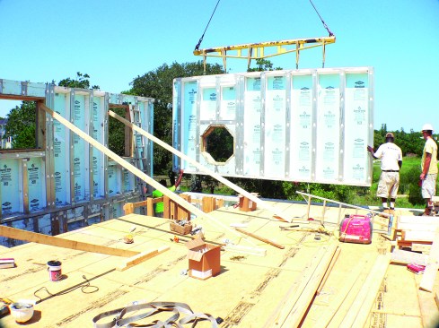

FLOOR FRAMING
In traditional stick framing, the floor platform rests completely atop the wall and flush with the outside. This creates a lot of joints that you need to air-seal, connect for uplift, protect from the weather, and so on. By contrast, Superior Walls panels have a 31/2-inch-deep “rim ledge” at the inside top of the wall, completely within the wall’s exterior skin, wherever the floor system needs to bear at the exterior wall. A 2×4 on the flat is cast into that pocket as a nailer and bearing shelf. Wall panels for higher stories rest directly on the concrete top of the panel below, with only one joint to seal and with continuous bearing from the base to the top of the structure.
The height of the floor support pocket can be specified as needed to accommodate the chosen floor framing system, whether that’s dimension lumber, trusses, or wood I-joists. (I prefer to use 12-inch wood I-joists whenever possible, as I did in this floor frame.)

Superior Walls panels are delivered with the window openings built in. Each window opening is wrapped with treated 2×10 southern yellow pine (SYP), which is attached to the concrete panel with 20d galvanized spikes that get cast right into the panel when it is made in the factory.
Superior Walls are a great product, but people make mistakes. If a window opening should happen to be 1/2-inch too small, and I’ve already bought the window, I’m in trouble. These openings can be modified in the field, but that involves considerable time and expense. So I don’t order any windows until my walls are on site. Then I measure the openings, and I custom-order the windows from Viwinco (viwinco.com) in Morgantown, Pa. This company is able to deliver a custom window with impact glazing at a competitive price, with just a 10-day lead time.

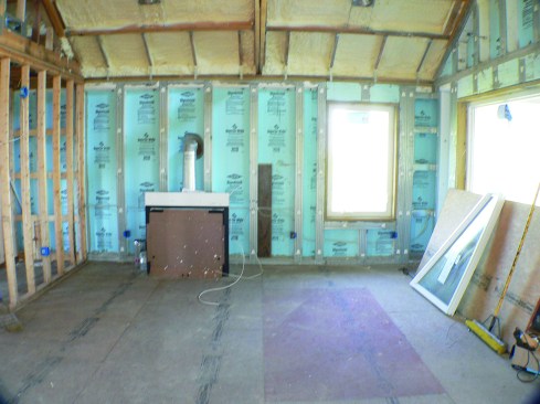

But if you need a hole (say, for a dryer vent) and there isn’t a preformed opening in the wall, you can knock a hole in the wall pretty easily with a diamond saw and a hammer drill. In this house, for example, there’s a freestanding gas fireplace in a third-floor room, vented through the wall. Between the concrete studs, the skin of the panel is just 1 3/4 inches thick. For that vent, the fireplace contractor just took a hammer drill, scored all around the opening that was needed, knocked the concrete out, and sealed a vent flange in.

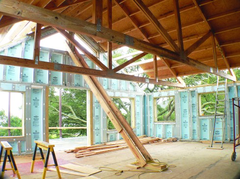

ROOF CONNECTIONS
One of the key elements in building for hurricanes (and tornadoes) is providing a vertical load path to resist wind uplift. The building industry has only recently begun to understand and accept this requirement. Simple things like roof pitches and eave overhangs can have a tremendous effect on the amount of uplift that can result when wind speeds reach 90 mph and more. My engineers have told me to plan on at least 45 to 55 psf of uplift from the roof deck in the case of a strong Category 3 hurricane with winds greater than 130 mph. That is a serious load, considering that an inland roof without heavy snow loads may only be designed for a gravity load of 10 or 20 psf. I have chosen to engineer all of my homes for at least 150-mph winds, which means paying close attention to the connection between the walls and the roof.
To ensure the connection of the roof assembly onto the Superior Walls panel, which is part of the vertical uplift load path, we use double 2×10 SYP top plates, through-bolted at 2 feet on-center with 1/2-inch galvanized bolts onto the top of the concrete wall panels. Each bolt connection is rated at 1,200 pounds. The trusses or rafters are then attached to this double top plate using Simpson H10 hangers (or equivalent). These are rated at 1,340 pounds each when nailed onto SYP. This gives me a roof attachment that should easily meet an engineer’s requirements for 150-mph winds with an 8/12 roof pitch.
It’s important to keep in mind that lower-pitched roofs have greater uplift than steeper roofs. Studies have shown that a 3/12 pitch creates the greatest uplift of all pitches. Conversely, pitches steeper than 8/12 have greater downward forces and less uplift. If local height restrictions force you to use a lower-pitched roof, you may need to increase the capacity of the roof-to-wall connection.

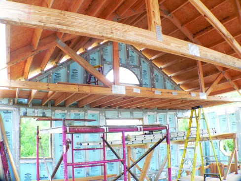

For this project, the Superior Walls crew set my gable end panels on the same day as my upper-story wall panels. My framers then framed the roof using a system of girder trusses and purlins.
I could have built the roof with a supported ridge and long rafters, but I probably would have needed to use 2×12 rafters because of the span. Instead, I made girder trusses out of 2×10 lumber and then ladder-framed between the trusses using 2×8 purlins. This allowed me to frame with less-expensive lumber, and it left me with 2 inches exposed on my girder trusses that I could wrap in finish trim.
This approach greatly simplified the framing. All we did was put hangers on the faces of the girder trusses, gang-cut the 2x8s, and drop them in.

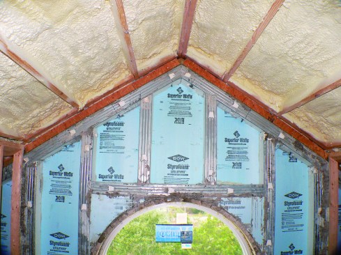

I sheathed the roof with 5/8-inch plywood, installed standing-seam metal roofing, and insulated the underside of the sheathing with 3 inches of spray-applied closed-cell polyurethane, which helps glue the roof deck down to the structure at the same time as it makes the roof-to-wall joint airtight.
