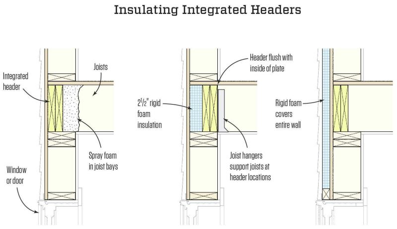

Q: What are the guidelines for letting rim joists act as headers in a wall system, and is there a way to insulate that header without sacrificing the bearing surface for the joists?

If you’re using floor-system-integrated headers to maximize insulation in the walls, you’ll want to insulate the rim joists (and the headers) as well. I suggest three different strategies depending on your specific situation. The first and easiest is keeping the rim joist and header even with the outside of the plate with the joists bearing on the plate, and then spraying foam insulation in each of the joist bays.
The next strategy is recessing the entire rim joist (and the header) up to 2 1/2 inches and installing rigid foam on the outside of the rim before the wall sheathing is applied. The inside face of the header can be in plane with the inside of the 2×6 plate, and the joists that terminate at the headers would then be supported by joist hangers. This leaves 1 1/2 inches of plate for the rest of the joists to bear, which is fine for conventional joist loading.
The final strategy is to install the rim joists and floor-system-integrated headers in the conventional way, flush with the outside of the plates. Then cover the entire wall with rigid foam, which is a growing practice being used to meet the increasing demands of the energy codes.
