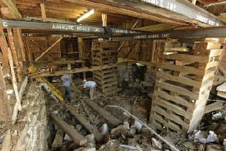

In the course of our remodeling work, we do a fair amount of house lifting, so we own around $20,000 worth of cribbing and long steel I-beams. Although we shored the roof and walls independently of each other, we did so off the same six stacks of cribbing. We cut through the first floor and set the cribbing on grade in two parallel rows. The rule of thumb when you set cribbing is to lay the bottom course at least 6 inches deeper than any anticipated excavation. It’s common sense; you never want to risk undermining the crib. We were excavating for a minimum 3-foot crawlspace and dug the cribbing in accordingly.
The cribbing supported two primary 60-foot-long steel I-beam “needles” running front to back through the structure. These beams picked up doubled 2×12 cleats that we lag-screwed to the front and back walls, and also supported four 40-foot perpendicular I-beams that in turn picked up 2×12 cleats along the side walls.
To support the roof and provide jacking points, we laid two 20-foot-long I-beams across the needles, directly below the 6×6 purlins that support the break between the lower and upper roof planes. We then built six site-laminated 6×6 posts, running them from the 20-foot I-beams up through the second floor to the purlins. Below the roof, we installed plenty of 2×6 cross-bracing to help the posts act as a unit and prevent bowing.

This arrangement allowed us to jack under each I-beam and the needles to gradually restore the building to a relatively level condition. We use ordinary, 20-ton short-throw hydraulic bottle jacks, set on cross blocking inside the cribbing, to make height adjustments. We never lift more than an inch at a time before reshimming and resetting the jack. If a hydraulic seal blows, you don’t want the building suddenly dropping several inches and pancaking on you.

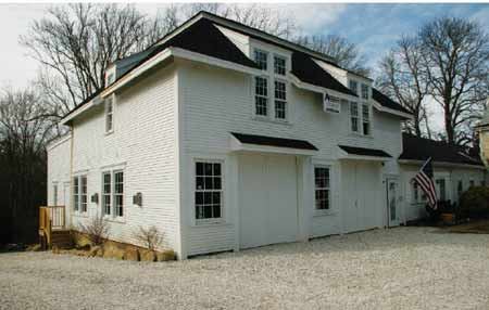

Looking at the plumb walls and flat ceilings in the new interior, you’d never know what rough shape this building had been in. And with new roofing, trim, and siding outside, the barn is good for another 100 years.
