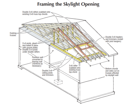

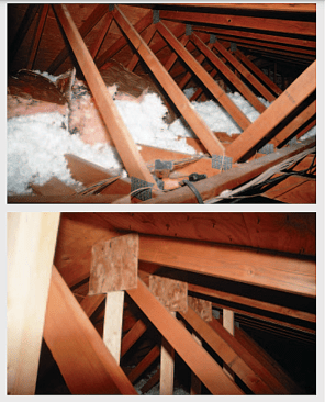

The roof of the ranch house in the photos was built with typical W-style trusses spanning from eaves wall to eaves wall. Fortunately, there was a partition wall running down the middle of the house, as there often is. By following the load path to the basement, I was able to use this partition wall as a bearing wall for the additional loading created by the skylight well (see Figure 1 above). The partition was built exactly like an exterior wall, with double top plates, so it didn’t matter whether the studs in the wall lined up with the trusses. The first thing we did was add 2×4 posts from the top plate of the bearing wall to the peak of the truss. We secured those connections with OSB gusset plates, glued and nailed in place. Adding these posts changed the single dual-slope truss into two mono trusses, making the two sloped sides of the roof independent of each other. We could then safely reframe the side of the roof that was receiving the skylight.
Figure 2. Adding posts under the roof peak transferred loading to a partition wall below, effectively creating two mono trusses from the original single full-span truss. The side of the roof with the well was then reframed conventionally with dimension lumber rafters, trimmers, and headers.
Framing the Skylight Opening
The first step in framing the skylight opening was to scab double 2×6 rafters onto the 2×6 truss top chords at each edge of the well area (Figure 2 above). These double trimmers ran all the way from the 2×4 posts at the peak to the top plate of the exterior wall. We doubled the posts under double rafters for extra bearing strength. These posts perform the same function as a structural ridge beam, providing support at the top of the rafter so the outside wall has no tendency to spread.

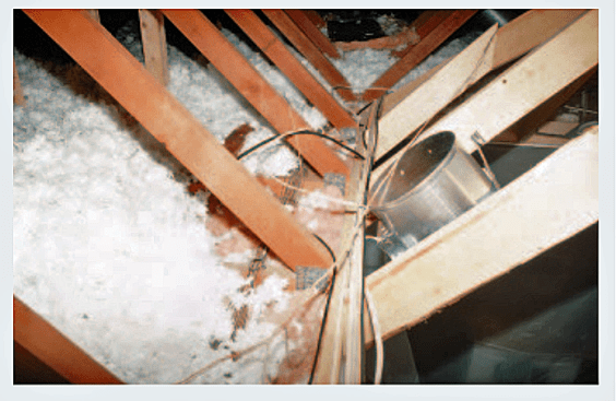

Adding these common rafters to the sides of the top chords supported the roof so that the webs and bottom chords of the trusses within the well area could be cut. On the job shown here, the well opening at the ceiling stopped right next to a metal truss plate. This was a plus, as it allowed us to leave a truss chord in place to provide support for the drywall ceiling while we framed the well (Figure 3 below).
Figure 3. Cutting the bottom chord of the truss a little beyond the metal plate allowed the original truss web to provide some support for the drywall ceiling.

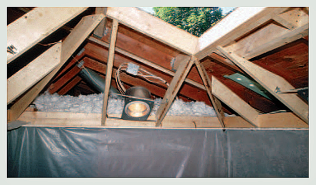

Once the webs and chords were cut, we installed double headers across the upper and lower edges of the skylight hole with joist hangers, then reattached the cut top chords of the two trusses within the width of the skylight opening.
The Flared Shaft

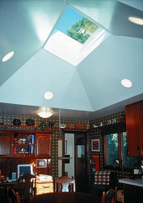

Next, we framed the ceiling opening with 2x6s, again using double trimmers at the outside edges. Finally, we framed the flared sides of the well — like framing an irregular tray ceiling. Nighttime lighting was part of the plan. The four recessed cans — one per side — make the skylight well an important source of evening light, rather than a dark hole at night (Figure 4 below). Recessed cans designed for slanted ceilings work well.
Figure 4. Recessed lights in the skylight well make it an important source of light and a visual focal point at night as well as during the day
