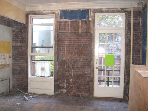

Hoboken rowhouses are typically long and narrow, with widths varying between 15 and 22 feet. To bring more light into the interior and improve backyard access, a popular renovation project here - especially during kitchen remodels - is to blow out the back wall on the ground floor and replace the standard door and window configuration with a wider three-panel door unit.
Wall construction. The brick pattern we encounter most often in Hoboken is American bond, where the stretchers (bricks laid flat with their long edges exposed) are interrupted every five courses or so by a row of headers (bricks laid flat with their short ends exposed). Stretcher courses are two layers (or wythes) thick, and the perpendicular header courses tie the inner and outer wythes together, reinforcing the wall assembly.
Floor framing and roof loads are typically supported by the brick common walls, which are often as much as 12 inches thick.
Robust as this type of construction is, you still need to take great care when you're widening a window or door opening, to prevent the two or three stories of brick above from collapsing. If we have any reservations about our ability to do the job safely, we consult with an engineer, who analyzes the loads and develops a shoring plan for the project (see "Installing a Wide Door in a Tall Brick Wall," 6/05).

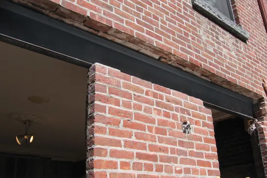

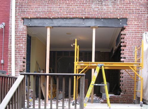

Split header. When we're working with a double-wythe structural brick wall and have complete access to the brickwork from both the interior and the exterior, we're usually comfortable removing the brickwork and installing the steel header specified by the architect without consulting an engineer or installing extra bracing. We do this by building up the header using two (or more) pieces of channel steel rather than a single I-beam.
A pair of steel channels bolted together flange-to-flange supports the double-wythe bearing wall on this project. Wire lathe and building paper for the stucco exterior are held in place by the washers. On some jobs the author orients the channels back-to-back, which makes it possible to bolt 2-by stock to the webs for attaching finishes.

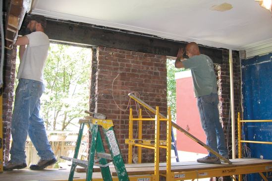

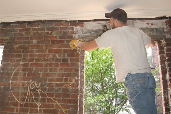

On the job shown in this article, for example, we started by gutting the finished wall and exposing the brickwork. After removing the door and window, we began chipping away at the inner wythe of brick with a rotary hammer and an angle grinder equipped with a masonry blade, dismantling just enough brick to install the first header section.
One advantage of this method is that it leaves the outer wythe of brick supported. Another big plus is that C10x20 steel channel - the steel we used for the two header sections - weighs only 20 pounds per lineal foot, considerably less than the single I-beam we otherwise would have needed. We could safely lift each header section into place by hand without any mechanical help.

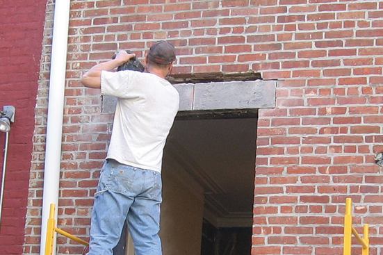

Once the first header section was in position, we used wood shims to lock the steel and brickwork together before moving on to the exterior. We removed the stone lintels over each opening and wedged in some temporary framing to support the brickwork above. Then we removed just enough of the remaining exterior brick to install the second header.
The headers were predrilled with 9/16-inch-diameter holes, so we had to spend some time tweaking and shimming the two sections of steel to align the holes.
On some projects the steel is left exposed and flush with the exterior wall. But on this one, the homeowners wanted the new steel header to be finished with stucco to match the granite lintels on the house's back wall. To prepare it for our mason's finishing touches, we primed the steel, flashed it with two layers of 30-pound felt paper, and installed wire mesh before bolting the two sections together with 1/2-inch-diameter bolts.
When we packed the gap above the header with Type S mortar, we temporarily left the shims in place. Later, when we started repairing the brickwork, we removed them and filled in the cavities with additional mortar. We also gave the header a mortar scratch coat to prep it for its stucco finish.

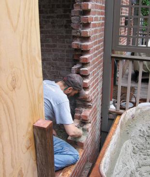

Once the steel is installed, the wall finish dictates how we complete the opening. On this project, the brickwork would remain exposed, so we removed it carefully to leave a toothlike edge, using brick chisels and our angle grinder. We rebuilt the opening by toothing in bricks we'd salvaged from the original wall and cleaned up. To help the new work blend with the old, we cut the mortar joints back so that our mason could touch them up later with color-matched mortar.
On projects where the wall has a stucco or brownstone veneer finish, toothing isn't necessary. When a wall has to be built out only a few inches, we simply form around the wall edge and fill the form with mortar. To build the wall out farther, we use concrete block reinforced with rebar.

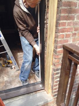

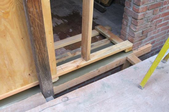

To make sure our windows and doors are sitting on a smooth and level base, we always cap the bottom of our rough openings with concrete sills that we form and pour in place. Once the rough opening is complete, we usually turn the job over to the millwork supplier, who fastens treated 5/4 bucks to the masonry, flashes the opening, and proceeds with the door or window installation.
