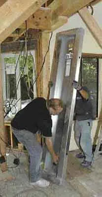

In most instances, shear panels are bolted directly to the foundation or slab, but on this remodel we wanted to attach the shear panels to the wood floor to avoid the complication of cutting out and resupporting joists. Although installation is simpler and shear values are higher when you bolt panels directly to a foundation or concrete slab, floor installations are necessary when you’re using panels on the upper levels of multistory buildings.
At first, McCleary considered using Simpson’s Wood Strong-Wall, but when he calculated the load he found that any wood panel wide enough to meet the shear requirement would not fit in the available 30-inch space. And whereas the steel version of this product — the Steel Strong-Wall — was strong enough to work in the available space, it was not yet approved for installation on top of framed floor systems.
The right panel for the job. Hence, McCleary specified Hardy Frame Panels, steel shear panels strong enough to replace the missing shear value, narrow enough to fit the space, and rated for use over floors framed with wood or light-gauge steel. Steel panels are stronger than similar-sized panels made from wood.
Had the end walls in this house been wider, we could have chosen from a variety of wood shear panels, all of which are rated for use over framed floors.

Since we wanted to complete the structural work as soon as possible, we purchased all the materials in advance. Fortunately, they were all stock items: two Hardy Frame Panels, four lengths of 7/8-inch threaded rod, a 6×12 Douglas fir header, a 6×8 Parallam to block joist bays, and multiple tubes of Simpson’s Epoxy-Tie Set adhesive.
