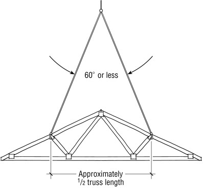

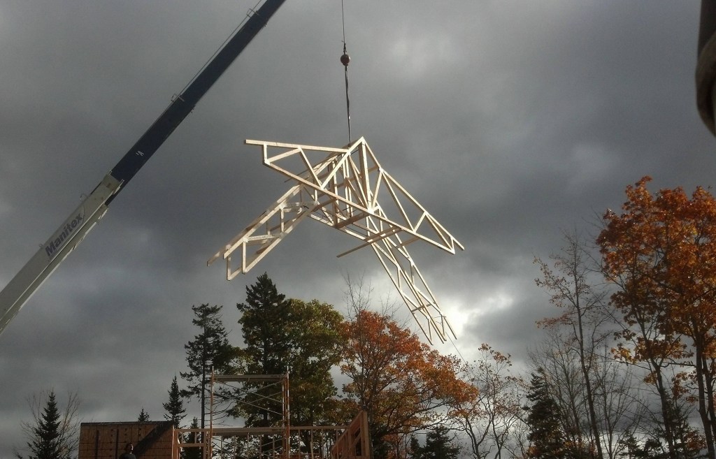

  • Banded trusses should be lifted off the truck from two points on the top chords. Individual trusses should be lifted the same way (Lifting Trusses, below).

To prevent trusses from twisting and damaging plate connections, lift trusses less than 30 ft. long at two balance points. Longer trusses require reinforcement with strongbacks before lifting.
