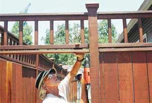

The spindle assembly on top of the fence came next. I juggled the spindle spacing so that a common spacing would work in all the post bays. And to hide slight discrepancies in the 8-foot post spacing, I didn’t place spindles against the posts.
I was able to get three spindles from a 3-foot-long PT baluster. I put a 15-degree cut on the spindle bottom to correspond with the bevel I made on the bottom spindle rail. After laying the cut spindles into a jig I’d made, I screwed them into the top rail.

The fence boards started out as 12-foot 1x6s. After cutting them in half, I turned them around and cut off both factory ends at 5 feet 11 inches. Since they were already prestained, the boards were ready for pilot holes — which, though they are not absolutely necessary, make installation much easier. Plus, level screws look better on the finished product.
Before drilling, I arranged the boards with the flat grain pointing down, so if the grain lifts in the future it will still shed water. Then I made a jig to drill the pilot holes.
Prior to installing the fence boards, I cut and applied 3-inch strips of Colbond’s Enkamat 7010 drainage matting (800/365-7391, www.colbond-usa.com) to the fence rails. Enkamat — a matrix of black spun nylon — creates a slight drainage gap where two pieces of wood are placed together.
To ease installation, I made a “sideways” story pole, marking it out with the nominal board width of 51/2 inches, separated by 1/8-inch gaps. With the story pole I could center the layout so that both end pieces would come out about the same width.
I could also easily determine whether starting with full boards on the ends and making the center board different would be a better option, as it was with the gate.
Once the fence boards were ready for installation, I sorted them for graining. The ones with the best vertical grain were set aside for the gate; other vertically grained boards were set aside for ripping into each bay’s end boards. The rest were arranged in agreeable patterns, with the best arrangements placed toward the front.
Before installing the boards on the horizontal rails, I ran a bead of Titebond III along each board’s top edge. Then I slid the boards into the dadoes and fastened them with 2-inch-long #10 square-head screws.

With everything straight and secure, I marked and cut off the fence posts and installed copper-topped post caps.
