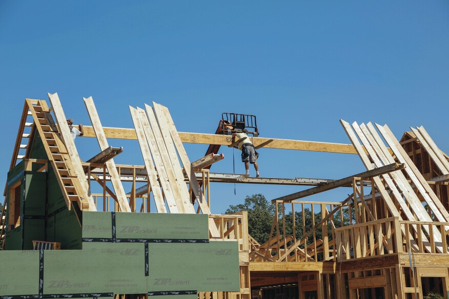

As part of the preparation for setting the ridge, I cut all the common rafters based on the rake measurement of the gable walls. We used a telehandler to lift the stacks of rafters up to the second-floor deck. The best access for setting the ridge would be from the back of the house, so on that side, we put the rafters in low stacks to keep them out of the way. On the front side of the house, we tilted the rafters up so they’d be within reach for installation.
Lifting the Ridge
The crew loaded the ridge onto the forks of the telehandler. The long LVL wasn’t that heavy, but its long length made it floppy and difficult to handle. To minimize this effect, we rolled the ridge up to a vertical position and then secured the middle of the ridge to the forks of the telehandler with ratchet straps. Jerry Beasley, my best telehandler operator, slowly drove the ridge around to the back of the house, and then brought the ridge as close to position as he could with the boom. We would do the rest.
I unstrapped the ridge from the forks, and we dragged it back until the north end was just inside the gable framing. One of the crew took the north end, lifted it on his shoulder, and slipped it up onto the ledger, and then we pushed the ridge into the slot between the gable wall plates.
The south gable was a bigger challenge. Instead of sliding the ridge into the slot between the plates as we did on the north end, we had to lift it up and drop it in. When we lifted the ridge, the lift angle added a little length to the ridge, so we loosened one of the gable braces to give us a little play in the walls. With the gable slightly loose, we slipped the ridge into the south slot and tapped it down to seat it at the proper height. We then moved the gable wall back into position against the end of the ridge.

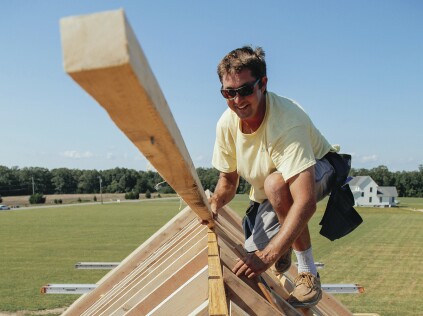

With the ridge in the correct position and the gables plumb, it was time to set the rafters. With rafters this long, this task is best done with a four-person crew: two crew members at the ridge and two others at the exterior walls—on each side of the building, and each with a framing nailer. The planks on the staging put the ridge at a comfortable working height for me, so I took the ridge duty along with another crew member who was close to me in height. Beyond the comfort factor, a good working height makes installing rafters faster and more efficient.
As a general rule, I always have the crew at the low end of the rafters nail them to the exterior walls before we secure them to the ridge. Fastening the low end first helps us straighten the ridge, because we’re using the weight of the rafter to our advantage to push the ridge into line.
Fastening in this order also sets the ends of the rafter in a straight line, which saves us time when we’re trimming soffits later. (These particular rafters transitioned to shallower-pitch porch rafters, so there were no rafter tails or soffits to deal with).
When the low end of the rafter was secured, my partner at the ridge set the rafter on his side in place so that the top was flush with the top of the temporary 2-by strip. Standing on the opposite side of the ridge, I then shot nails through the ridge to secure the rafter in place. After nailing the rafter on one side, I set the opposing rafter on its layout and toenailed through the top of the rafter so that I could drive it into place. My ridge partner then nailed it at an angle from the opposite side.
As we continued down the ridge installing the rafters, we would reverse roles if my partner’s side seemed looser than mine, and I would tap my side into place first. We also kept checking the straightness of the ridge by eye. If we’ve cut our rafters accurately, securing the rafters straightens the ridge and holds it straight.
